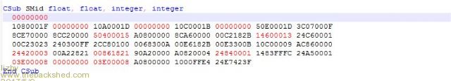

Ok, colors--thank you.
The only thing that jumps out at me initially is that in CFunctions, some of the numbers display in red and some in black.
MMEdit does the same, but different numbers are red. This is of no consequence to me.

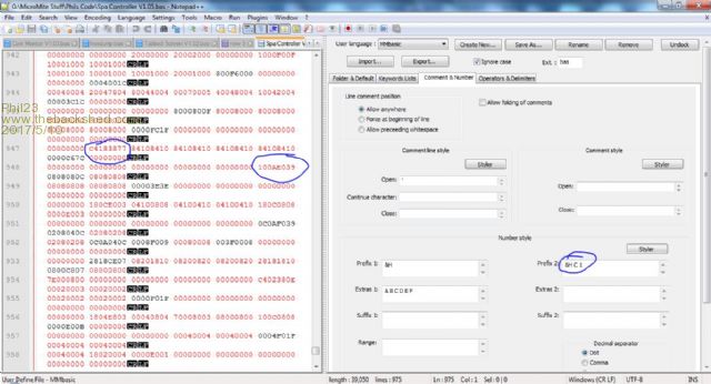

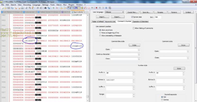

  lizby said   Ok, colors--thank you.
That seems to be related to the "Prefix 2" in the numbers definition.
See in these examples, adding 0-F in this field should fix that bit.
Dunno if it will break it else where.
Phil.
Phil23
Joined: 27/03/2016
Posts: 1667
Posted: 12:31am 10 May 2017
Not really readable above, but Prefix 2 needs:-
0 1 2 3 4 5 6 7 8 9 0 A B C D E F
In the above example I just added C & 1 after the &H for a test.
Phil

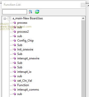

Posted: 09:04pm 11 May 2017
Really Don't understand the XML here, but getting this result...
Notice it's picking up the End Sub & End Function words....
this is the Parser I'm using, wbut it's a bit out of my depth.
[Code]<function mainExpr="((SUB|FUNCTION)).*?(?:\(|$)" displayMode="$className->$functionName"> [/code]
Can anyone tell me how to make it ignore the END SUB & END FUNCTION lines?
This is the entire functionList.xml I'm working with ('we are hacking a VB section pasted near the end).
Would be great if someone could help out in getting the last step.
Phil.
