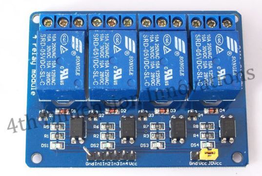

I now have a 4 Channel relay sitting in the roof space.
This one to be precise.
Some of mine even came with additional bent pins as a bonus...
Connected is:-
A 2 speed inline fan, 840³m/hour, draws 105 watts on high.
A 240V motorised damper valve. Drive open/drive closed type.
Relay connections are:-
Channel 1 - Fan High Speed
Channel 2 - Fan Low Speed
Channel 1 - Damper1, NO contact to "Drive Open", NC contact to "Drive Close".
Channel 1 - Spare
Few Questions on Best Practices.

The shield isn't necessary, for noise suppression, as the inputs are very low impedance. They connect the Gnd to the optocouplers. No need for any caps either.
The optocouplers merely serve as level translators, as the ground pins on both the 3 pin and 6 pin connectors are physically connected by the PCB copper ground plane, so they cannot serve as high voltage isolation.
The yellow jumper connects the JDVcc +5V supply pin to the Vcc +5V supply pin of the 6 way connector. This allows you to run a seperate 5V supply for the relays if you leave it out.
Proper operation with a 3V3 input voltage would surprise me as the combined series voltage drop across the indicator LED, internal opto LED and the series current limiting resistor (R1) would probably be a bit much. You would most likely be better off connecting Vcc, of the 6 pin connector, to +5V and configuring the uMite pin as open collector (make sure it is a 5V tolerant pin). Maybe it works at 3V3 (haven't tried it). It's just that the theory doesn't add up.
Anyway, to get over voltage drop (10m of 26AWG @ 150mA) I would suggest the following -
1) Use the shield drain wire for Gnd pin of 3 pin connector.
2) One parallel pair of conductors for JDVcc pin of 3 pin connector. Leave out the yellow jumper.
3) No connection to Vcc pin of 3 pin connector.
4) Connect the above to a 5V (6V) supply of your choice. Observing polarity.
Connect a plugpak (wall wart), as described above if you wish, and retain the spare conductors. Voltage drop will no longer be a problem. When you start off at 5 volts every bit counts.
5) One conductor for pin 6 of 6 pin connector. Connect to 3V3 (5V) on uMite board.
6) One conductor for each input and connect to respective uMite output pin.
If pin 6 was connected to 5V ensure that any uMite pin is 5V tolerant and configured as open collector.
See the drawing below for an idea of the circuit on your board. Only one channel shown. It is the best educated guess I could come up with just looking at pictures on the web.
Hope this helps
