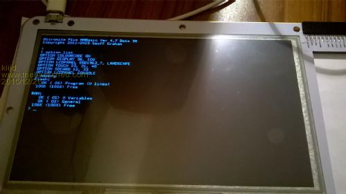

and what I'm wondering is whether it is possible to use the Micromite as a "primary" display, or otherwise simulate it? I saw kiiid's "MM+ school laptop " which appears to be doing what I have in mind:
but I'm not sure if that's e.g. hardware VT100 or VGA or ... ? If there's no straightforward solution, is there a way to "emulate" console functionality e.g. using an "exec"-type command to run BASIC commands from within another program that handles the UI, i.e. something that looks like this:

i believe that, at the moment, this is well beyond the abilities of the MX170. there is simply not enough flash memory space available to provide this level of functionality. if microchip were to come out with an MX190 (with double the flash) that would perhaps be another matter.
one solution would be to use two MX170 micromites. one as the 'main processor', while the seconds one would run an MMbasic program that was a VT100 terminal emulator using an attached colour LCD screen and keyboard. in essence, you would be using the backpack as a tiny VT100 terminal.
cost wise, two MX170's are probably about the same price as one MX470, so there is not a great gain if you are happy using SMD parts.

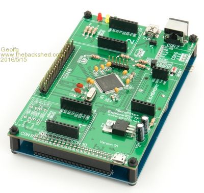

If you want to have a self contained computer then you have to use the Micromite Plus (MX470 chip).
Grogster has designed a backpack like PCB for the MM+ designed to fit on the back of a 5" SSD1963 display. This includes a keyboard interface so the whole thing can act as a self contained computer with SD card storage. I am currently writing an article describing it and it should appear in Silicon Chip (an Australian magazine) in a few months. This is a sneak preview:
Kon's School Laptop uses the same chip but is more sophisticated.
