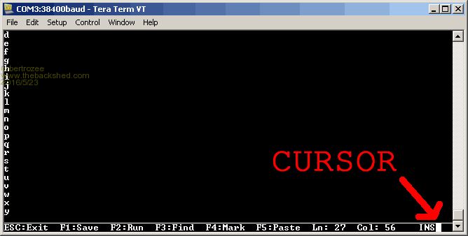

Posted: 01:30am 14 May 2016
excellent work geoff
just loaded the new version using pic32prog and it works well. i have spotted a few errors in the manual, should these be reported to this thread? they are small ones!
a couple of ideas (do feel free to ignore):

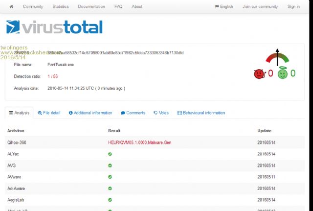

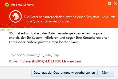

Strange:
I hope this is a false alarm! I'm on it ...
Uploading FontTweak.exe to Virus Total --> seems to be safe!
