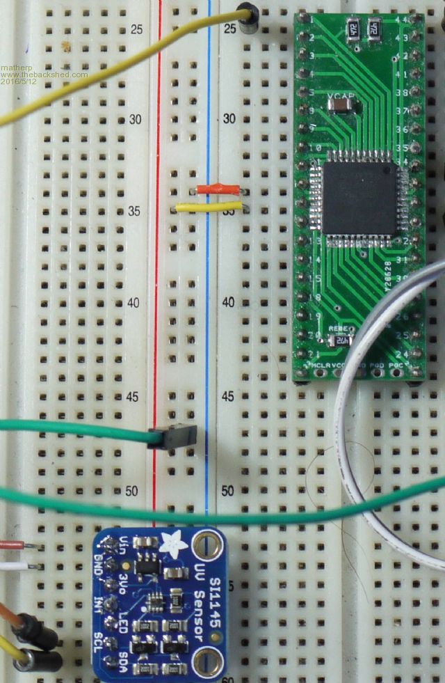

At lew247's request here is a simple 1:1 port of Adafruit's code for the SI1145 Digital UV Index / IR / Visible Light sensor
