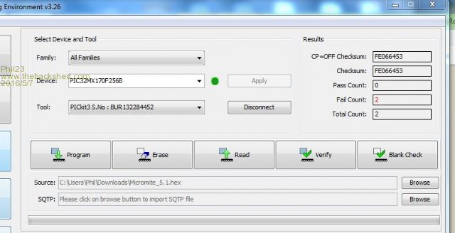

Any suggestions on this error.
Connecting to MPLAB PICkit 3...
Currently loaded firmware on PICkit 3
Firmware Suite Version.....01.41.07
Firmware type..............PIC32MX
Programmer to target power is enabled - VDD = 3.300000 volts.
Target device PIC32MX170F256B found.
Device ID Revision = A2
2016-05-07T22:09:09+1000- Programming...
The following memory area(s) will be programmed:
program memory: start address = 0x0, end address = 0x3ffff
boot config memory
configuration memory
Device Erased...
Programming...
Failed to program device
Selected device and target: memory mismatch.
2016-05-07T22:09:15+1000- Programming failed
Pass Count: 0
Phil

It happens whenever the programming pins are (excessively) loaded by other devices/components than the PICkit: are those (pin 4 and 5) connected to anything but a 2K+ resistor or other IC input pin (especially capacitors, low impedance loads such as a LED, another IC output pin, etc) ?...
If the answer is yes, then you can't program the PIC in-circuit unless you can disconnect the offending load (I usually use the MM pins 4 and 5 as outputs, or connected to a load that hooks to the board via a connector, and can therefore be disconnected during reprogramming of the PIC).Edited by piclover 2016-05-08

  piclover said   It happens whenever the programming pins are (excessively) loaded by other devices/components than the PICkit: are those (pin 4 and 5) connected to anything but a 2K+ resistor or other IC input pin (especially capacitors, low impedance loads such as a LED, another IC output pin, etc) ?...
It was just a bare MX170 plugged into a bread board & connections to the programmer made with 10cm jump leads.
Absolutely no other components.
I was powering it from the Pickit3 with the "Power Target from tool" option,
and it seems that was the issue.
Plugged a 3.3/5.0 volt module in and it programmed fine.
Thanks.
