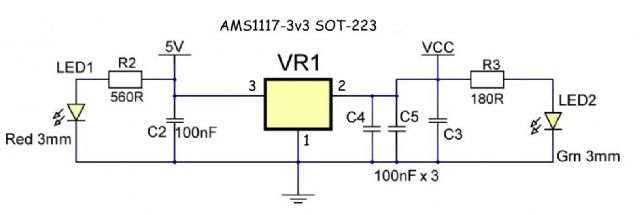

GDay Phil,
This is the schematic of the Power Supply circuit I use for my MuP and indeed the entire range of my 'mite range and it has been working very reliably (touches wood as I type that)..
The 3 capacitors on the output stage are basically because they appear around the board there are only 2 100nf caps near the VReg, 1 on the input, 1 on the output..
The specs state there should also be a 47uf on the input but using good clean 5v supplies (such as USB and "plug-pack/wall-wart" chargers) I have not heard of any issues as you are seeing..
