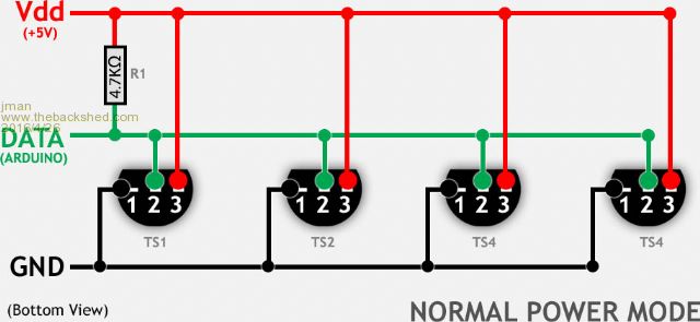

Do you have the sensors connected like the pic below?
What value is your pullup resistor? and is to 5V
Jman
Jman
Hi,
That's basically how I have them connected. the pullup is right at the MicroMite, between +5 & the I/O pin I am using, and it's 4.7k. They are all powered off the 5 Volt rail.
Happy to post feedback from the 6 sensors I currently have. I have another dozen or so on the way.

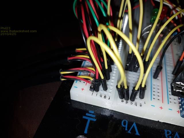

In the picture I posted above, sensors connected to the bread board;
5 have 3m cables, the 6th one is only 1m.
Initially I had 3 connected;
