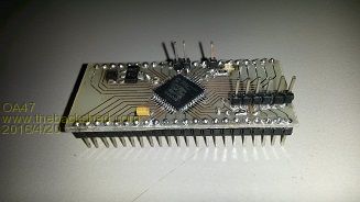

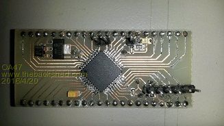

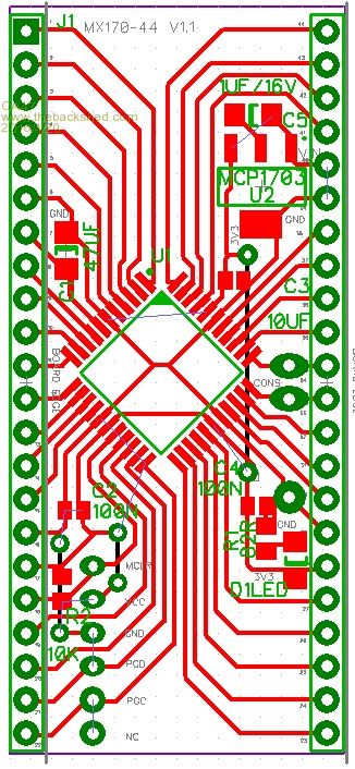

I needed a couple of quick prototype boards for the 44 pin version of the Micromite so I thought I would have a go in house (I should have said 'in shed'). I managed to produce a single sided layout that I could make with the press-n-peel process. I have the DipTrace files available for any one who would like them.
Here is the DipTrace File zipped:
2016-04-20_093520_44pinMX170V11.zip

Very nice - the only thing I'd be a bit worried about is the regulator, its only 250mA
while this would be fine for just the micromite, if you wanted to power other items plugged into the micromite from it, it's a bit low?

It is amazing that you fitted it on to a single sided board. Congrats.

@ Lew247 just used components that I had on hand. After all this is only a prototyping board and you could upgrade the regulator if needed.
@ Geoffg Thanks, thought it would be a bit of a challenge and it has been good to have another SMD project to try to develop my soldering skills.
