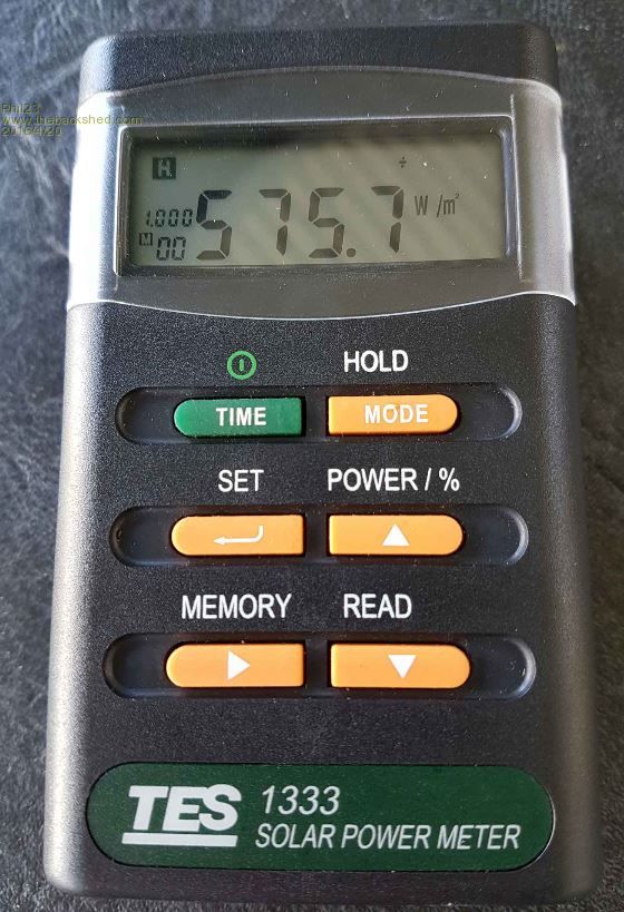

Out of Interest,
I'm getting 575Watt/mē at 10:30am; Panels facing N/W with 11° inclination.
Voltage across the 10Ohm is 780mV, which equates to 60.8mW.
1.0 Volts gives me 100mW, so the figures roughly equate to the Solar energy available.
Edit:-
Now showing around 700W/mē,
680mV which equates to 70.6 mW's at the resistor.
Close enough for the intended purpose.
Cheers.
