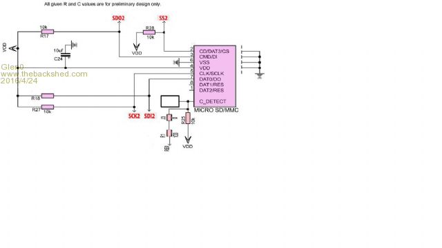

When first configuring the SD card I can only use "OPTION SDCARD 14" and not "OPTION SDCARD 14, 18" as shown in the micromite plus manual.
The snadpic manual shows both CD and CS on pin 2 of the SD card socket, which then
connects to pin 14 of the Pic Micro
