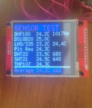

Comparing temperature sensors. The BMP180 and TMP107 appear to be the most accurate. The DS18B20 reads about 0.6C high, the DHT22 about 0.8C low, and the SHT21 about 0.3C high.

Interesting. How did you know what the real temperature was?

The TMO107 has a typical accuracy of +0.2C Max error +-0.4C. The BMP180 accuracy is typically +-0.5C Max error +-1.5C. As the two are agreeing, it is likely that they are showing nearly the correct temperature.
A mercury in glass thermometer (not a finely calibrated one) is reading about 0.8C below the TMP107/BMP180.

Typical temperature reading errors using BMP180/TMP107 as reference
DS18B20. +0.8C
DHT.22. -0.9C
SHT21. +0.2C

The most accurate value would be from the DS18B20 (+/-0.2°C typical, at 25°C, and +/-0.5°C over the full temperature range).
The BMP180 sensors are very inaccurate for temperatures, not only because the base accuracy is lower (+/-0.5°C typical, +/-1.5°C max, at 25°C) but also because of self-heating (0.65mA during conversion instead of 1mA for the DS18B20, but the latter got a much larger package which dissipates heat much better, and can be located away from the (itself self-heated) circuit board, unlike the SMD BMP180...).
The purpose of the BMP180 temperature sensor is not even to provide accurate ambient temperatures but just to allow for temperature compensation of the pressure sensor, according to the calibration coefficients stored in the BMP180 ROM.
I don't know about the DHT22 (never used those).
Note that for all sensors, it is of uttermost importance to keep them far away from the main circuit board and out of the main circuit board casing: else you will measure the temperature of the circuit board or of the case (and yes, they can both heat up by 1 or 2°C above ambient temperature, even when fitted with low power electronics).
To avoid self-heating, you should also avoid doing too frequent measures (1 measure every 15 seconds should make self-heating negligible in most cases).Edited by piclover 2016-04-28
