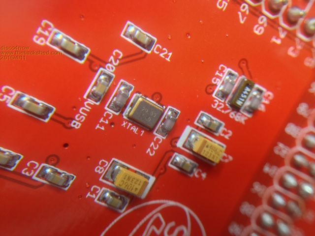

Picture of back of board.
Someone that's done the change themselves might chime in with more info.
Gerry.

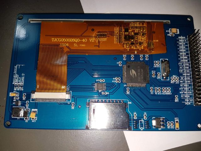

LCD Panel arrived 1/2 an hour after my last post.
Haven't tried to lookup any data for it just yet, but here's a couple of pics.
Someone might instantly recognise it.
Phil

I have one of those Phil, it should be fine with the SnadPic board (with the correct Xtal). You'll have a lot of pins to connect up, I use mine on one of Matherp's 64 pin 'Ultimate Backpack" boards which has a header already wired for it. There are a few points you should check especially re the backlight control - see the last few posts on this thread which is about the 4.3" 480x240 board but it's applicable to your 5" 800x480 which uses the same ILI1963 controller. In case you don't already have it, here's the schematic for your display. 2016-04-11_053209_Schematic.pdf

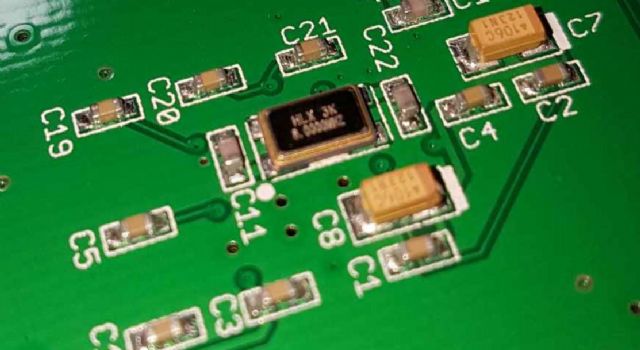

Received the board today,
It has an 8.0MHz Oscillator on it.
Ordered the 20Mhz ones mentioned above, but they are much smaller.
This one is 5 x 3mm roughly.
Does this one look like the correct replacement?
Thanks.
Phil

The crystal on the board is similar to the 8MHz on on your board, it has the marking
FXC 20.0 and XU06. The best bet would be to email the guy at SnadPic and I am sure he will be happy to set you right.
Paul

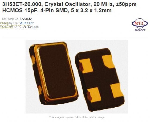

So the one I mentioned above, from RS components may not be correct?
Ordered one today on the off chance....

Hi All,
Received the crystal I ordered today.
Is someone able to confirm it is correct? Wasn't 100% sure.
Also any advice on replacement would be appreciated.

The datasheet for what you have is here. See it has VCC ,GRN ,control and Output
for the 4 pins.
datasheet
As I posted above I think this is not what you want. You just need the crystal.i.e.
Crystal
If you scroll down on the above link you see that even though it has 4 tabs ,it just has the crystal between tabs 1 and 3.
For removal, I would used a bit of solder on the tip of the iron, and place against each pad in turn while slightly levering up. Repeat for otherpads. Once off, clean up the pads.
When replacing, use plenty of flux and solder will wick underneath the pad ok.
You could take it off and poke around with a meter between the pads to verify what you have looks like what is taken off. Pretty sure you need to get just the crystal.

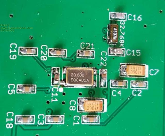

So I finally got the correct Crystal (I hope) and replaced the 8MHz one with a 20MHz.
Presume I also have to remove the 32.768k one as well?
Is that all then good to go?
Someone mentions capacitors....
Phil

Coming into the discussion totally cold but I would imagine the 32.768MHz crystal is for a Real Time Clock and therefore needn't be removed?
There will be two padding capacitors with the crystal but these would only require changing if the 20 MHz rock's requirements differ from the 8 MHz rock's. Do you have specs on the 20 MHz's requirements?
