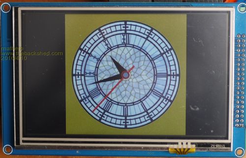

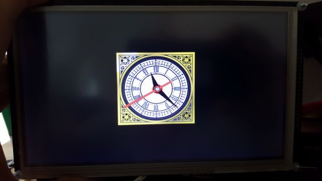

The clever bit is a new CFunction that reads one or more triangular shapes off the display into a buffer and then can write one or more single colour triangles back onto the display.
Why triangles? Because they are the easy way to display a rectangle rotated by other than multiples of 90 degrees. A rectangle can be considered as two triangles by splitting it along one of the diagonals. Using simple trigonometry we can rotate the points making up the triangle about an arbitrary point and then we can then use the "fill triangle" routine to display it on the screen.
The clock program uses two triangles for the second hand and one each for the minute and hour hands. Of course, the technique is infinitely expandable to any number of triangles and not limited to "clocks".
The key calls in the program are:
if first then
i=triangles(nt, buff() , tcol(nt), xx0(nt), yy0(nt), xx1(nt), yy1(nt), xx2(nt), yy2(nt))
print "Read buffer is ",i/buffersize*100,"% used"
first=0
else
i=triangles(nt*2, buff() , tcol(), xx0(), yy0(), xx1(), yy1(), xx2(), yy2())
endif
The first time into the code the CFunction is called to read in the background where the first triangles are to be written and write out the required number of triangles (nt). The background is read into the array "buff". It does this when the colour for the triangle is specified.
Subsequently, the same call is used but with twice the number of triangles. In this case the first set have the colour set to -1. This tells the CFunction to write out the triangles using whatever is stored in "buff" and you will see in the rest of the program the coordinates of the first set of triangles are those previously displayed. This restores the background to its original status. The the new triangles are then drawn but as before their background is read and stored before they are displayed.
As the CFunction does all the difficult work the complete program is pretty simple.

option explicit
option default none
const buffersize = 2500
dim integer buff(buffersize)
dim integer nt=4 'Number of triangles being updated
dim integer xx0(nt*2-1),yy0(nt*2-1),xx1(nt*2-1),yy1(nt*2-1),xx2(nt*2-1),yy2(nt*2-1),tcol(nt*2-1),secs,mins,hours,first=1
cls
load image "bigben.bmp",160,0
Circle MM.Hres\2, MM.Vres\2, (MM.Vres\2-MM.Vres\12)\12, 0, , rgb(red), rgb(red))
Circle MM.Hres\2, MM.Vres\2, (MM.Vres\2-MM.Vres\12)\15, 0, , 0, 0
Circle MM.Hres\2, MM.Vres\2, (MM.Vres\2-MM.Vres\12)\20, 0, , RGB(gray), RGB(gray)
secs=val(right$(time$,2))
mins=val(mid$(time$,4,2))
hours=val(left$(time$,2))
do
hands(secs,mins,hours,(MM.Vres\2-MM.Vres\12),MM.Hres\2, MM.Vres\2)
secs = (secs + 1) mod 60
if secs=0 then mins = (mins+1) mod 60
if hours=0 then hours = (hours+1) mod 12
pause 1000
loop
end
Sub hands(seconds As integer, minutes as integer, hours as integer, size as integer, x as integer, y as integer)
Local integer x1,y1,x2,y2,x0,y0,i
local float angle=seconds*6
rotatetriangle(2,RGB(RED),angle,x,y,-3,50,3,50,-3,-size) 'make up the second hand with two triangles
rotatetriangle(3,RGB(RED),angle,x,y,3,-size,3,50,-3,-size)
angle=minutes*6 + seconds/10
rotatetriangle(0,RGB(BLACK),angle,x,y,-size/15,0,size/15,0,0,-size*0.8)
angle=hours*30 + minutes/2
rotatetriangle(1,RGB(BLACK),angle,x,y,-size/12,0,size/12,0,0,-size*0.5)
if first then
first=0
else
endif
Circle x,y, size\12, 0, , rgb(red), rgb(red))
Circle x,y, size\15, 0, , 0, 0
Circle x,y, size\20, 0, , RGB(gray), RGB(gray)
sub rotatetriangle(n as integer, col as integer, angle as float, x as integer, y as integer, x0 as integer, y0 as integer, x1 as integer, y1 as integer, x2 as integer, y2 as integer)
local float sine=sin(rad(angle)),cosine=cos(rad(angle))
local integer x0a,y0a,x1a,y1a,x2a,y2a
x0a= x0*cosine - y0 * sine + x
y0a= y0*cosine + x0 * sine + y
x1a= x1*cosine - y1 * sine + x
y1a= y1*cosine + x1 * sine + y
x2a= x2*cosine - y2 * sine + x
y2a= y2*cosine + x2 * sine + y
xx0(n)=xx0(n+nt)
yy0(n)=yy0(n+nt)
xx1(n)=xx1(n+nt)
yy1(n)=yy1(n+nt)
xx2(n)=xx2(n+nt)
yy2(n)=yy2(n+nt)
xx0(n+nt)=x0a
yy0(n+nt)=y0a
xx1(n+nt)=x1a
yy1(n+nt)=y1a
xx2(n+nt)=x2a
yy2(n+nt)=y2a
tcol(n)=-1
tcol(n+nt)=col
end sub

Peter you do some amazing stuff.....
PS on the Big Ben glass can I read cafe?
GM
Posted: 12:39am 10 Apr 2016
Nice one!
@ OA47 - Yes, you can. I can see it too, and there is another word under that, but I can't make it out.
Posted: 12:44am 10 Apr 2016
  Quote  PS on the Big Ben glass can I read cafe?
Some sort of watermark on the image lew247 sent me. Seems to say "cafe press"

Attached, Royalty Free picture (very similar to the above)
Definitely no watermarks, I bought the picture to get it royalty free - so feel free to use it.
Size 480 X 480 so it will fit in the program perfectly.
Unfortunately I cannot upload the zip file of the correct .bmp file as it's too large.
Right click on the picture and you should be able to download it.
Edit: for some reason when you download it, it's coming up as a .png file - but you can convert it to .bmp using any program or send me a message with your email address if you want me to send you the original which is a lot larger (or this size in bmp format)

2016-06-17_204306_bigben.zip Matherp - or anyone else
Could somone be so kind as to tell me the mods to get the hands of the clock showing in the correct position and size please?
I have resized the clock face so it's 240X240 pixels and have it positioned on the left hand side of the screen in the centre of the display
I have it showing correctly where i want it with the following section of code
[code]load image "bigben.bmp",0,120 [/code]
However I cannot work out how to get the actual clock hands in the correct position.
[code]
[/code]
I believe that is the centre circles of the clock and it gets its position by asking the display what size it is then dividing that size by 2 to get it in the centre (MM.Hres\2, MM.Vres\2)
I THINK that's how it works
[code]hands(secs,mins,hours,(MM.Vres\2-MM.Vres\12),MM.Hres\2, MM.Vres\2)[/code]
I THINK that does the same with the hands
The bit I cannot work out is how to position the hands in the centre of my clock!!!!!

Posted: 10:51am 17 Jun 2016
You know the exact size of the bitmap and you know where you put it on the screen. Work with those values and not use the Hres and VRes variables.
If the bitmap is 240x240 and you placed it at 0,120
then the center will be 0+120, 120 + 120 -> x=120,y=240
Draw a small circle to make sure you are exactly in the center, then work from there.

long x1=x,x2=x+width-1,y1=y,y2=y+height-1;
unsigned long xstart,xend,ystart,yend,Vertical,Horizontal;
#ifdef MX470
RSLo;
#endif
if(Option->DISPLAY_ORIENTATION==LANDSCAPE || Option->DISPLAY_ORIENTATION==RLANDSCAPE){
xstart = x1;
xend = x2;
ystart = y1;
yend = y2;
} else {
xstart = y2;
xend = y1;
ystart = (HRes - 1) - x2;
yend = (HRes - 1) - x1;
port=0x22A ;WRLo; WRHi; // RS low
#ifdef MX470
RSHi;
#endif
port=(xstart>>8 ) | Both; WRLo; WRHi; // RS HIGH
port=(xstart) | Both; WRLo; WRHi; // RS HIGH
port=(xend>>8 ) | Both; WRLo; WRHi; // RS HIGH
port=(xend) | Both; WRLo; WRHi; // RS HIGH
#ifdef MX470
RSLo;
#endif
port=0x22B ; WRLo; WRHi; // RS low
#ifdef MX470
RSHi;
#endif
port=(ystart>>8 ) | Both; WRLo; WRHi; // RS HIGH
port=(ystart) | Both; WRLo; WRHi; // RS HIGH
port=(yend>>8 ) | Both; WRLo; WRHi; // RS HIGH
port=(yend) | Both; WRLo; WRHi; // RS HIGH RSHi;
void writeRectangle(int x1, int y1, int width, int height, int fc, char p[]){
unsigned long i,fhb,fmb,flb;
// make sure the coordinates are kept within the display area
// convert the colours to 888 format
fhb = (fc >> 16) | Both;
fmb = (fc >> 8) | Both;
flb = fc | Both;
defineregion(x1,y1,width,height);
#ifdef MX470
RSLo;
#endif
port=0x22C ; WRLo; WRHi; // RS low
#ifdef MX470
RSHi;
#endif
i=width*height;
while(i--){
port=fhb; WRLo; WRHi;
port=fmb; WRLo; WRHi;
port=flb; WRLo; WRHi;
int ReadRectangle(int x1, int y1, int width, int height, int pos, char p[]){
unsigned long j,n, RDpin, RDsetport, RDclrport;
RDpin=1<<GetPinBit(Option->LCD_CS);
RDsetport=(unsigned int)GetPortAddr(Option->LCD_CS,LATSET);
RDclrport=(unsigned int)GetPortAddr(Option->LCD_CS,LATCLR);
j=width*height*3+pos;
#ifdef MX470
RSLo;
#endif
port=0x22E ; WRLo; WRHi; // RS low
#ifdef MX470
RSHi;
#endif
trisinv=0xFF; //set pins to read
do { //read in the screen area to be overlayed
RDLo;
n=DEVID;n=DEVID;;n=DEVID;
RDHi;
p[pos++]=(read & 0xFF);
RDLo;
RDHi;
RDLo;
RDHi;
} while(pos<j);
trisinv=0xFF; //set pins to write
return pos;
int RestoreRectangle(int x1, int y1, int width, int height, int pos, char p[]){
int i;
#ifdef MX470
RSLo;
#endif
#ifdef MX470
RSHi;
#endif
i=width*height;
while(i--){
port=p[pos++] | Both; WRLo; WRHi;
return pos;
long triangles(int mode, int buffpos, char *buff, long col, long x0, long y0, long x1, long y1,long x2, long y2) {//Cfunction
long a, b, y, last;
long dx01, dy01, dx02, dy02, dx12, dy12, sa, sb;
if (y0>y1) {
swap(y0, y1);
swap(x0, x1);
if (y1>y2) {
swap(y2, y1);
swap(x2, x1);
if (y0>y1) {
swap(y0, y1);
swap(x0, x1);
if(y0==y2) { // Handle awkward all-on-same-line case as its own thing
a=x0;
b=x0;
if(x1<a) {
a=x1;
} else {
if(x1>b) b=x1;
if(x2<a) {
a=x2;
} else {
if(x2>b) b=x2;
if(mode==0){
buffpos=ReadRectangle(a,y0,1,b-a+1,buffpos,buff);
} else if(mode==1) {
buffpos=RestoreRectangle(a,y0,1,b-a+1,buffpos,buff);
} else {
writeRectangle(a,y0,1,b-a+1,col,buff);
} else {
dx01=x1-x0; dy01=y1-y0; dx02=x2-x0; dy02=y2-y0; dx12=x2-x1; dy12=y2-y1; sa=0; sb=0;
if(y1==y2) {
last=y1; //Include y1 scanline
} else {
last=y1-1; // Skip it
for (y=y0;y<=last;y++){
a=x0+sa / dy01;
b=x0+sb / dy02;
sa=sa+dx01;
sb=sb+dx02;
a=x0+(x1-x0) * (y-y0) / (y1-y0);
b=x0+(x2-x0) * (y-y0) / (y2-y0);
if(a>b)swap(a,b);
if(mode==0){
buffpos=ReadRectangle(a,y,b-a+1,1,buffpos,buff);
buffpos=RestoreRectangle(a,y,b-a+1,1,buffpos,buff);
} else {
writeRectangle(a,y,b-a+1,1,col,buff);
sa=dx12 * (y-y1);
sb=dx02 * (y-y0);
while (y<=y2){
a=x1+sa / dy12;
b=x0+sb / dy02;
sa=sa+dx12;
sb=sb+dx02;
a=x1+(x2-x1) * (y-y1) / (y2-y1);
if(a>b) swap(a,b);
if(mode==0){
} else {
y=y+1;
return buffpos;
/*void setrd(long *RD){
Option->LCD_CS=*RD;
ExtCfg(Option->LCD_CS, EXT_DIG_OUT,0);
ExtCfg(Option->LCD_CS, EXT_BOOT_RESERVED,0);
PinSetBit(Option->LCD_CS, LATSET);
int gettearscanline(void){
int n,a,b,RDpin, RDsetport, RDclrport;
char x[10];
#ifdef MX470
RSLo;
#endif
port=0x245 ; WRLo; WRHi; // RS low
#ifdef MX470
RSHi;
#endif
RDLo;
n=DEVID;n=DEVID;n=DEVID;n=DEVID;
RDHi;
a=(read & 0xFF);
RDLo;
RDHi;
b=(read & 0xFF);
return (a<<8)|b;
long long main(long *count, char *buff, long long col[], long long x0[], long long y0[], long long x1[], long long y1[],long long x2[], long long y2[]) {//Cfunction
int i=0,j,buffpos=0;
do {
j=gettearscanline();
} while(j>409 || j<400);
while(i<*count && col<0){ //repeat for any restores
buffpos=triangles(1,buffpos,buff,col,x0,y0,x1,y1,x2,y2);
i++;
buffpos=0;
j=i;
while(i<*count && col>=0){ //repeat for any store and write commands
buffpos=triangles(0,buffpos,buff,col,x0,y0,x1,y1,x2,y2);
i++;
i=j;
buffpos=triangles(2,buffpos,buff,col,x0,y0,x1,y1,x2,y2);
i++;
return buffpos>>3;

@matherp
Please can you confirm something.
I have taken the code from your original post, and replaced the 'CFunction triangles' chunk with that from your post above (for the 100pin). I am using an Explore100 with 7" TFT and MMBasic v5.2 as available on Geoff's website.
The first time I ran the code I got a CPU exception error. I re-ran it and all was ok, but I started editing the code. My question is, should I restart the MM if I change my code so that the CFunction side of things 're-establishes itself correctly'?
I ask this because if I make a single change to the code (and then don't reset), I notice something briefly flash up on the screen (several times - but way to quick to see what it is) and then I see 'BigBen'. Best way to describe it is like a total screen flicker of about 5 times, then BigBen drawn ok. HOWEVER, the hands then are sometimes drawn correctly, but more often than not are drawn in the incorrect position.
Every time I restart the MM after editing my code, all seems to work fine.
I seem to remember a historic post from you that recommended re-starting the MM if CFunctions are used so just need your feedback if thats ok
WW
Posted: 09:06pm 26 Jul 2016
  Quote  @matherp
I'm away from home so unable to test. You shouldn't need to reset. A possibility is that your code is using somehow assuming memory is in a certain state (i.e. zeroed) which is only the case after a reset. Is the buffer memory big enough for the triangles you are saving?
I can look at this properly late next week if you post your full code. I personally didn't see any problems when I did the Explore-100 mods.
Posted: 10:08pm 26 Jul 2016
Thanks Peter.
The code is literally your first post, with the 'CFunction triangles' replaced with the 'new' 100pin version above.
Was also using Lewis' smaller BigBen Image.
Then in the DO...LOOP I simply added PRINTing the time to the console (PRINT TIME$)
The reason I haven't posted the code is that it has long gone - but this is what I was doing when I first observed the 'screen flickering & misplaced hands'.
By the way, because of the additional time to send the TIME$ to the console, the PAUSE 1000 caused drift between the PRINTed time, and the 'analogue time' (since you are not re-reading the TIME$).
So I then brought into the DO....LOOP the few lines of code above the DO loop that set the secs, mins, hours, from the actual TIME$; and then reduced the PAUSE 1000 to PAUSE 10.
Let me be clear that your code / program works - just any change to it causes the flicker & hand mis-location occasionally, UNLESS I reset the MM in which case it works first time (every time).
I commented out the PRINT ... buffer line but noticed it was 83% (or 88%) on the first time I ran the program. Because it was 'upsetting' my display - I commented it out as the first thing I did.
Will try all this myself again latter and let you know how it goes . . .
WW
Posted: 10:59pm 26 Jul 2016
  Quote  By the way, because of the additional time to send the TIME$ to the console,
That was a c..p way of doing it. See my second post on the first page of the thread where I replace this with a "correct" method
