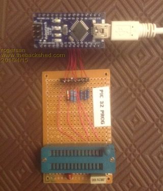

Posted: 04:02am 15 Apr 2016
Here is a photo of my programmer using the Aduino Nano.
