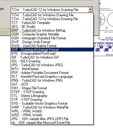

Here below is what my CAD files can be exported as......
I see that there is reasonable cost software on the market that can do conversions, like GerberView etc, but I am not sure it this software will work.?
My JPG files of the layers/masks comes out real nice, and at real size. PDF come out to scale but some pads have turned octagon, and no longer round.

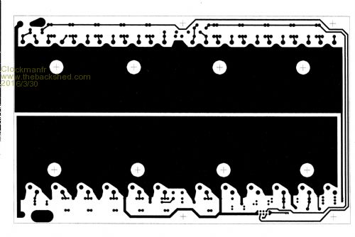

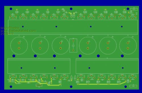

Here is a reduced quality jpg of the board layout.
As you can see, the FET legs are deliberately splayed out. The copper double side boards should be double thickness ie 70 micron. The heat sinks and the caps down the centre are deliberate, as these are forced cooled when the board is pulling serious kW's. The board design is optimum for copper use, and boy do I need plenty of copper around those FET's. Might even need to beef that copper up, but will test first.

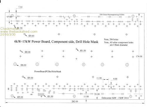

Here is the drill mask with some dimensions.

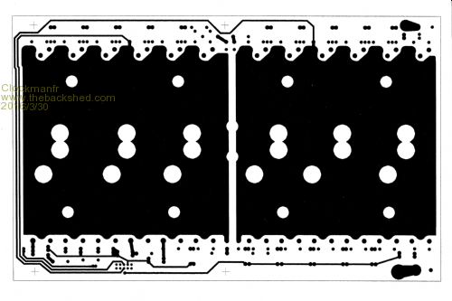

Just so you can see what your getting involved with....
Top board Mask.....

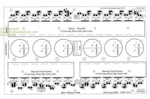

And under board mask.....this is a Mirror as it fits on the underside from the underside.
EPS files are okay and look reasonable.
I also have both side pad tin masks, and silk screen mask.

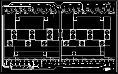

I downloaded the free version, the version I ordered will come in the post in the next couple of weeks.
The freeware version took my DXF files and converted it to a lined, Polygram, and holed layout, with each entity being recognised by the Target software and at scale.
The tracks will have to be re-laid at the correct thickness, pads, will need re-laying and areas will need filling, but in general the software is at least seeing the DXF, so that's good.
I find Target is clunky and not laid out for folk like me. Line size, pad size, drawing tools etc, are not intuitive as I would like.
However getting the now saved Target file to a gerber file is complicated to say the least. How do you do it please?.

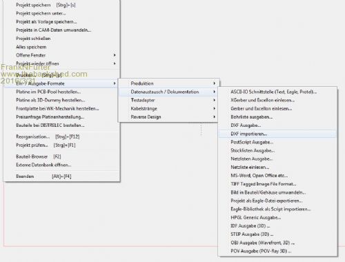

It's relative simple to convert DXF in Gerber:
- create a new job with board only (without circuit)
- import DXF (you have many import functions)
- you can export to Gerber with:
- Files - In-/Output-Formats - Production - (X-)Gerbers
...or press simply F11
- specify your folder and press "Start"
Let me know if I can help you!

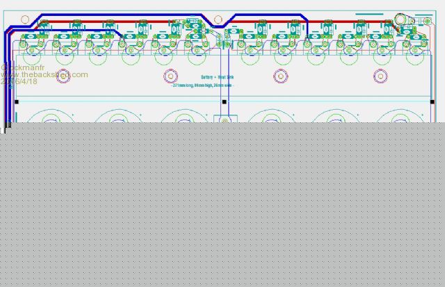

Import of DXF into AutoTrax
But then I found that Autotrax DEX imported into the DOCUMENTATION layer which doesnt actually get generated in the Gerber prints..
There is one other possibility..
We can convert to a picture format and DEX will allow that to be imported onto the copper ... I think... It is used to add a logo or other image but I do not think there is a size restriction.

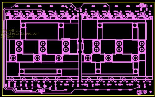

Hi Clockmanfr,
this is your DXF file, imported by Target, exported as Gerber and viewed with GC-Preview:
It seems to be a problem that your tracks are created with many fine lines...
Your problems with the IBF site are strange - you can change your language to French, English or German...
Frank

Thanks for looking bigmik.
Hi Frank.
Yes that's what I get, regards all the fine lines, its CAD entity blocks that define an area where you want a colour change. The way I use it is rough, dirty and quick to keep it a simple drawing without getting the layers mixed up.
However for future reference I can clean those perimeter lines up and just use one line and fill. Not sure about those big holes though.
Target see's all those lines perimeters from the DXF and what's better if you click on them in Target you can manipulate them, I think?.
Grid will need redefining on the TARGET redraw, I normally set it at 0.25mm. So is it possible to redefine the big areas of copper and fill within Target before going to Gerber?
Can we resize the lines to correct size?
Obviously, I wont get this software for a while so hence me asking.
If you zoom in on the Gerber file, how are the track lines,? they should be 1mm wide, 2mm wide between close pads.
