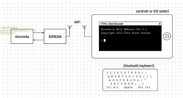

it is pretty neat, but not quite what i have in mind - the crome plugin essentially turns chrome into a teraterm workalike, with the connection to the target via a wired serial port (according to the demo video).
perhap this diagram better shows what i have in mind:
rob :-)
Posted: 05:52am 27 Mar 2016
That's what I thought you meant but it does seem extraordinarily painful to "want" VT100 between the left 2 items (umite & esp).
