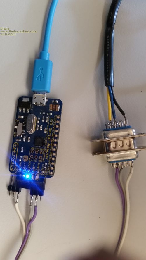

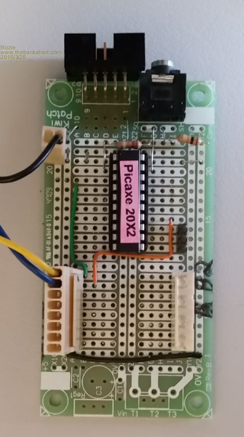

I have been following with interest the thread "Circuit diagram". In which there has been discussion about power drain via Rx/Tx lines. Well here is one for you all to ponder!
In the images below you can see a picaxe 20X2 with three wires going to it from a freetronics USB-Serial adaptor - NO OTHER WIRES BUT the picaxe is running!
I could show you TeraTerm with a screen full of "Ready!!!"'s but I will not, just to prove it is working.
Now I accept this is a fault on this board as changing boards does not replicate the fault but I can not find what is wrong. Other boards do however show a similar voltage across pins 1 and 20.
I can use a different picaxe and the fault continues, I can even reprogram the picaxe using this setup.
If I disconnect the blue wire (Tx on USB adapter) the pic stops.
Anyone seen the phenomenon before? - May be useful to parasitically power a picaxe!?

It is common to any modern digital device.
It is drawing its power through the built in protection Diodes.
Each I/O line has two diodes one to V+ and one to V-.
Dave Jones did a Video on the subject recently:
EEVblog #831 - Power A Micro With No Power Pin!
https://www.youtube.com/watch?v=2yFh7Vv0Paw
