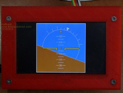

I've finally finished the AI display algorithm but it is not yet integrated with the attitude sensor. This was a real pig to write as I wanted it to allow for 360-degree roll and pitch (something the mechanical AIs can't handle) but there a couple of interesting algorithms that may be generally useful.
Demo video
The first is a new CFunction "dcirch" this draws a circle outline but allows you to specify part of the circle to be omitted.
The calling sequence is
dcirch x, y, r, c, x1, y1, x2 ,y2
x = x-coordinate of centre of circle
y = y-coordinate of centre of circle
r = radius of circle
c = colour
x1,y1 coordinates of top left of box to be omitted
x2,y2 coordinates of bottom right of box to be omitted
so:
[code]
dcirch 100,100,50,rgb(white),0,100,mm.hres,mm.vres
[/code]
will draw just the top half of a circle. The screen area of the bottom half won't be touched.
The other interesting algorithm is the Cohen-Sutherland algorithm
CohenSutherlandLineClip(x1,y1,x2,y2)
This bounds a line specified by x1,y1, and x2,y2 to remain within the screen area defined by the global variables xmin, ymin, xmax, ymax. Sounds easy but just try and do it from first principles
In the case of the AI display this was needed to get the coordinates of the horizon line bounded by the AI display area.
Complete test code for the AI display module below. As before this needs a 4.3" SSD1963 display to run properly using the paged driver
