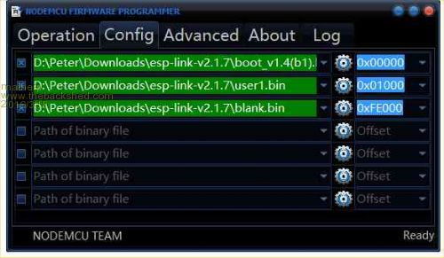

There are so many uses of the ESP8266 and today I thought I'd try using it as a simple Wifi to UART converter.
There is some nicely written code freely available here . I just downloaded the binaries (no need to install the Arduino IDE or compile anything) and used the NodeMCU Flasher 64-bit windows program to load it up. There is also a 32-bit version available
Depending on what you have been running on your ESP8266 it is worth completely erasing it before loading new firmware. This program has the option to do that. I found that the program wouldn't overwrite ESP8266 Basic without completely erasing first.

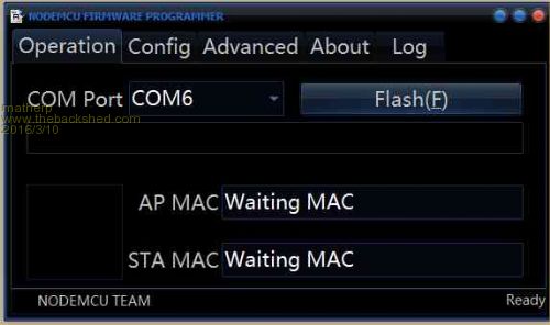

Once you have downloaded the Wifi/Uart binary run the NodeMCU Flasher and set up the three bits of the binaries to be flashed on the "Config" tab
The instructions on Github are quite good but miss the issue of where to load "Blank.bin". On a 1MB ESP load it to 0xFE000. On a 2MB version use 0x1FE000. On a 4MB one use 0x3FE000. I haven't tried using one of the early 512MB ESP8266.

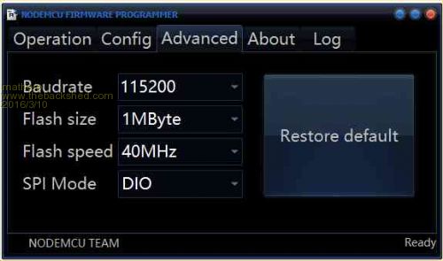

Set the Flash size on the "Advanced" tab. The ESP8266 will automatically adjust to the baudrate set but 115200 works well
Finally, go back to the "Operation" tab and click "Flash"
As always when flashing an ESP8266 GPIO0 needs to be connected to GND. I also find that after clicking "Flash" then briefly grounding the RESET pin on the ESP8266 will result in 100% success in flashing.
Once the ESP is programmed follow the instructions on github to configure it for your wifi network. Remember to remove the GND on GPIO0 and reset the ESP.

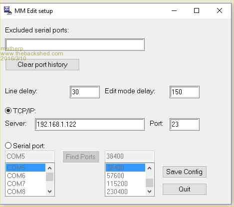

Then use your favourite console program (it is MMEDit I assume) and create a Telnet connection to the IP address that the ESP software reported. I then create a fixed IP allocation for the device's MAC address on the router so I know it will always be on the same address.
From then on you have normal console access to the Micromite as though it was wired via USB - excellent . Programs download from MMEdit just as normal allowing easy remote program update.

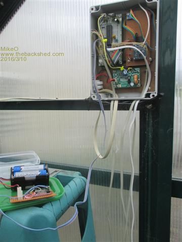

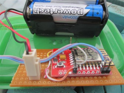

Totally agree with Matherp. I have been using this program very successfully for some time, see my earlier post. One caveat, whereas MMEdit chat communicates fine I usually use Teraterm in conjunction with MMEdit and I could not get teraterm to work reliably in this case (I have used teraterm over TCP/IP previously ok). In my post I do refer to another Terminal program I found however and it works very successfully it even has macros and file transfer so I am still able to use Tassy Jims excellent "Crunched" file transfers.
By the way if you still want to use 38000 baud you can set the serial rate in the ESP8266 programs Web page.
My unit in use on my weather station.
Mike

  matherp said   There are so many uses of the ESP8266 and today I thought I'd try using it as a simple Wifi to UART converter.
Just trying to flash one of these.
Not sure how to Identify the flash size.
Anyone help?
Edit:-
At the risk of bricking it I've tried flashing it a 1Mbyte, but doesn't seem to finish.
The programmer constantly flashes up:-
require("wifi")
require("gpio")
connect.world()

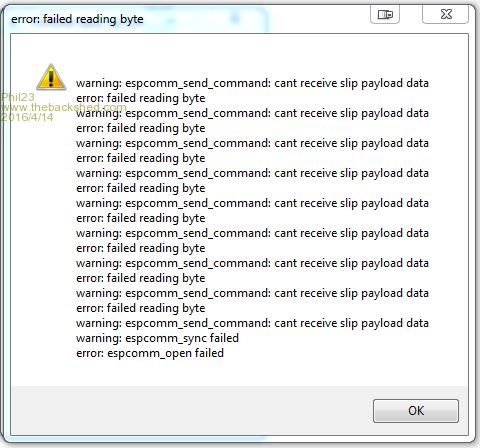

Tried to run ESP_Basic_Flasher.exe but it returns an error when I try to connect to com10:, error:espcomm_open failed.
Edited by Phil23 2016-04-14
Posts: 12086
Posted: 09:23pm 12 Apr 2016
If your PCB is black then 1MB is correct if it is blue then it is 512kB. If it is blue try loading blank.bin to 0x7E000
Make sure your wiring of the module is correct - see here

Also if I try & run ESP_Basic_Flash.exe I get:-
Totally frustrating, having spent 30 years in IT, something that seems to be a handicap at times.

You do have GPIO0 pulled low when programming and the remove the connection and reset afterwards?
Are you powering from the CP2102? That won't work - you need a really meaty 3.3V supply as the ESP8266 takes serious power intermittently when transmitting on wifi
