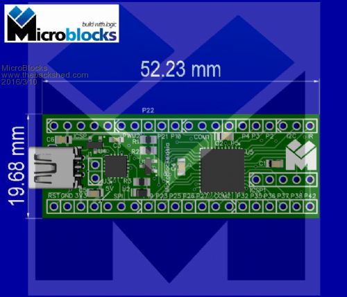

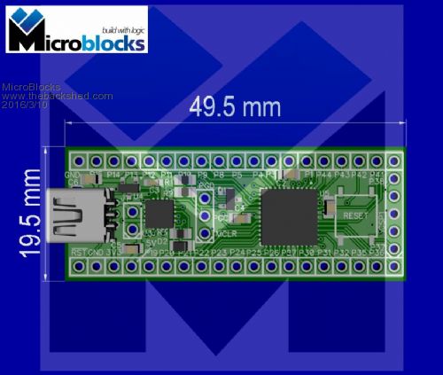

Just finished laying out a pcb that has a 44 pin MX170 together with my USB-Serial/programmer.
All in a convenient DIP 40 sized pcb.

After some feedback i managed to make the size a little bit smaller so that it is a better size for the pcb manufacturer. (Thanks Mick!)
Also added a reset switch, rotated the icsp for the MX170 and moved the icsp for the pic16f1455.
The icsp is only needed when you want to connect a pickit3 and use its debug capabilities. For programming you can just use the USB.

I am going to remove the reset button and use the space for something more useful. I mean how many times would you need to press the reset when it is embedded in some box. :)
I was thinking about maybe a RTC, FRAM, IR sensor etc.
The I2C pins and the IR pin are already on that side of the pcb so it would be easy to route.
I often see users needing some way of keeping values even after a restart. A small FRAM would be ideal i think. For an RTC there are so many version and you of course need a crystal and a battery, which will fill up that area quickly.
I just measured the area and i think there is enough space for an FRAM and an RTC and an IR sensor.
The FRAM could be 32Kx8 bit, no idea which RTC and IR sensor yet.
Any suggestions what would be useful to have.
It can be a footprint only so that it is an optional part.

Jean,
If you can move the USB connector UP a wee bit you can probably fit 2 holes for a RESET jumper..
As to what else in that space?
Hmmm, SPI and I2C headers maybe?
EDIT !!!!
Maybe swing C6 under the board (assuming it is components both sides) if not I think there is still room to move.
MikEdited by bigmik 2016-03-12

Posted: 08:32pm 10 Mar 2016
MB,
Is is possible to upload a high res (zipped or PDF) of the overlay as it is quite hard to see in the TBS crunched image?
I understand about components 1 side, if no others are there then dont put C6 there either..
Also where are R3 and LED?
Posted: 08:42pm 10 Mar 2016
Mick, good eye as there was enough space to add a reset jumper.
I will upload a highres image and link to it. A moment....
Edited by MicroBlocks 2016-03-12

Posted: 09:02pm 10 Mar 2016

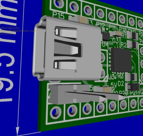

R3 and LED are right below the small pic.
I see that the silkscreen still says D2 and that the 3d model is a diode, don't have a 3D model of an SMD led so i used it as a placeholder.

  MicroBlocks said   Any suggestions what would be useful to have.
Hi Jean,
If you're thinking maybe an RTC then a DS3231/2 would be the obvious I'd guess. The firmware for it is in MMBasic, it's accurate, no crystal needed, and you can get temperature from it. 'Only' problem is the battery but maybe a jumper?
Greg
Posted: 02:10am 11 Mar 2016
Yes, i considered them but unfortunately they are in a relative large package.
The DS3231 does not fit in the remaining space and the DS3232 is even bigger.
Such a pity as they have lots of NC (not connected) pins.
I guess most space is used for the internal crystal.
Posted: 02:21am 11 Mar 2016
MB,
The DS3232MZ is a VERY SMALL 8 pin device I use on my SMD-BP170 however they are not cheap at about $12 Aus .. But it should fit in that space and those who need the accuracy can decide if the cost us worth it or go for an add on board.
Posted: 08:06am 11 Mar 2016
Ouch that is expensive. But if you need it a footprint will be nice.
I'll see if i can squeeze it in.
Maybe i have to reconsider using the bottom side for optional parts. I might be able to also put in a footprint for a FRAM 32kx8bit chip.
Then add a footprint for a IR sensor and then that are is probably as full as can be. :)
