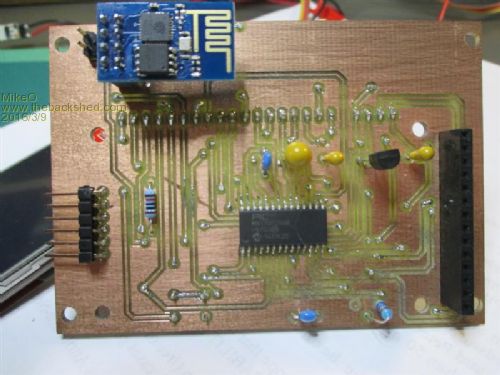

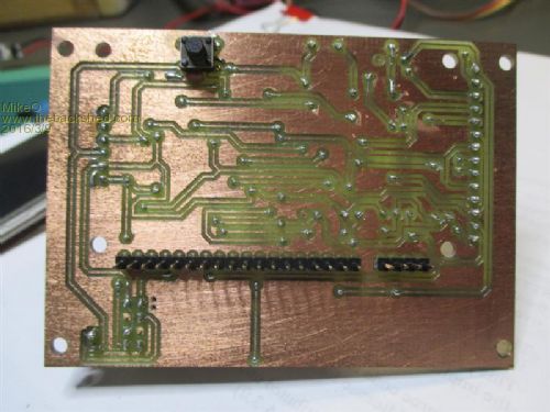

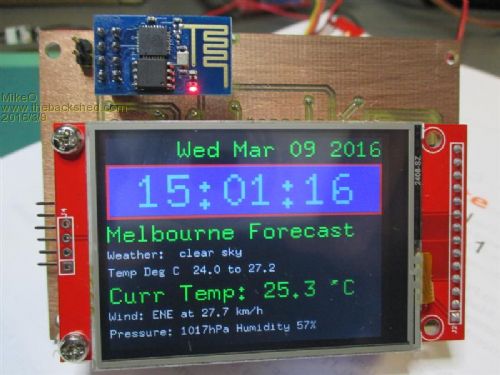

Well yes but with a few differences. Its an adaptation of Geoff's excellent backpack uMite 170 but with a couple of differences, it has a ESP8266 on board it uses a SOIC version of the MCU but lastly the board was cut by CNC! (Useful when you don't want 10 prototypes)
The Clock is synced from the Internet by NCP and it fetches your local weather from OpenWeatherMap.org
The project was really just to test out the board but it could be useful!
Some Photos
Cheers Mike

Hi Mike,
That looks like it was fun to build
Will you be willing to share the code for others to learn from?
And out of interest - are you using the 2.4 or 2.8 there?
Brilliant job

Posted: 12:09am 09 Mar 2016
Hi WW, the display used was the 2.4

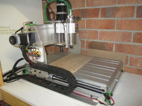

Here is the Micromite and ESP8266 code. If anyone is into PCBs by CNC I can post the NC files.

Codenquilts

I really like the CNC pcb. What CNC and bit did you use to do that?

Would like to see a picture or two of your CNC rig if possible. Have you used it to machine panels or enclosures or similar light weight project parts, or is it made specifically for just PCB milling?

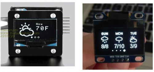

Now we just have to figure out how to make cool little icons like these...
Maybe using the font editor tool from TassyJim and make a special "font" with icons. Putting two or three characters together to form a cool icon... Thinking out loud (thats dangerous...)

MikeO
Joined: 11/09/2011
Posts: 275
Posted: 08:44am 09 Mar 2016
Hi Jim, Yes I had noticed just recently something about Json on the ESPbasic site but I didn't go into it, I probably should! I have to say I find the ESPbasic site mighty frustrating to read and the documentation is woeful but non the less I should spend some time and get up to date again.
CNC, Its a Carving 6040, I used a 20degree V cutter.

Posted: 09:53am 09 Mar 2016
HankR, yes I do use it to make enclosures and front panels particularly as well as PCBs.
The enclosure in my project was made on the CNC.

  viscomjim said   Now we just have to figure out how to make cool little icons like these...
Not dangerous at all!
I have been making 'large' fonts for this very reason (some fonts as big as my screen resolution!!).
No need to join several characters together, just set a picture/icon size and create a font with TassyJim's EXCELLENT font editor 'app'.
This would be a fantastic addition to the next version of a MicroMite Clock
And even better if Geoff/Jim allows for multi-coloured fonts (not that I'm asking for sprites or anything )
If I get time I will create some 'clouds' symbols for us folk here in UK; and some sunny symbols for you guys on the opposite side of the planet

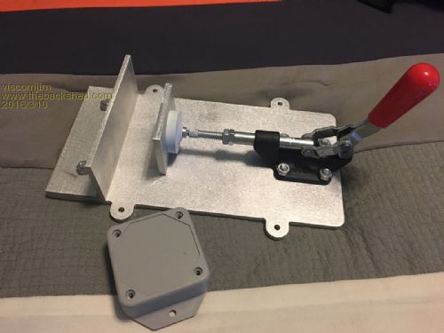

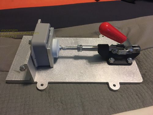

Maybe we should start a new topic, but while we are at it, I use a cnc router to machine abs boxes for projects. Using a nice upcut spiral carbide bit at 20,000 rpm makes the boxes cut like butter and extremely clean cuts to boot. Like Mike O says, holding the workpiece is the catch. When I have to do more that 5 or so, I build a jig that can screw down to the surface of the router table. This way every unit is placed the same and everything lines up perfectly. Here is an example of a jig used to machine some little abs cases...
