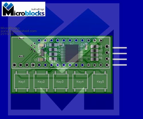

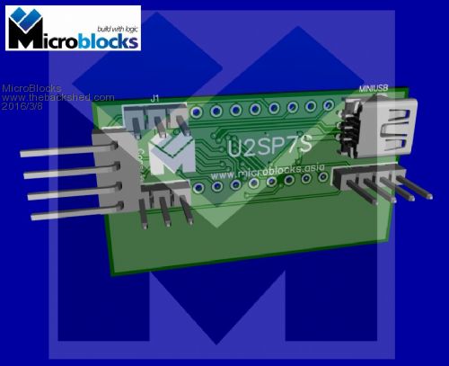

I designed a little PCB that can hold a 4 digit 7 segment display.
While i was doing that i realized i had some pins left and used them to add USB to Serial and some switches.
I would like to keep my 'MicroBlocks' compact and easy to use, but also versatile.
Sometimes however i go a bit too far and i was wondering what you guys are thinking.
Should i keep the switches or make the board smaller by dropping them?
Size of the pcb is 42x14mm without keys and 42x24mm with the keys.

  MicroBlocks said   Should i keep the switches or make the board smaller by dropping them?
Of course the best is always make both versions, but for me this is a pretty easy decision on how to vote. I'd prefer a smaller board (thus lower product cost I hope), but do include some pads for the switches.
Often a designer might need the switches off-board; in fact, that is probably the vast majority of cases.

  Quote  but do include some pads for the switches.
If all five can't fit, even two or three would be useful.

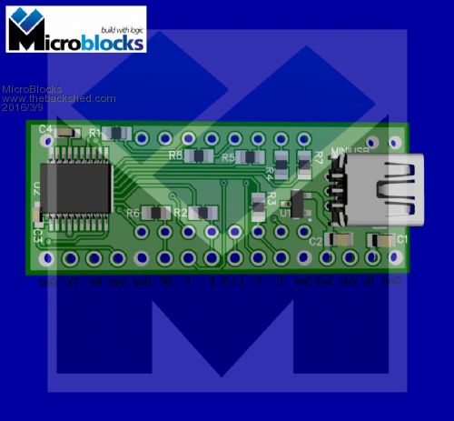

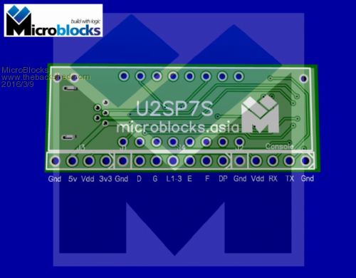

I agree with your points. I never have switches directly on the pcb, so that is another point in favor of just providing the connections.
I changed it accordingly and also moved the parts to the bottom of the pcb so that any heat can dissipated more easy and is not trapped between the LED and the PCB.
Also if something breaks it is easier to do a repair as all the parts are reachable.
