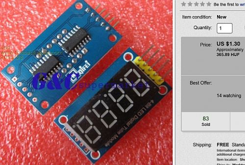

Hello,
Inspired by this link:
idea
This is an example for interfacing the 4 digit display from Qifei.
Sorry, the display can only show one single digit at a time.
So we need to time multiplex the display fast enough, and
with the Basic interpreter is not so good. (like software controlling
a stepper motor...)
Here are the picture, and MM44 program.
