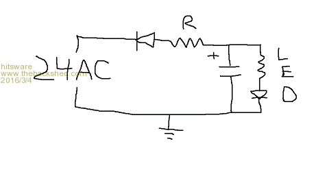

hitsware
Joined: 23/11/2012
Posts: 535
Posted: 12:51am 04 Mar 2016
You don't need the cap either,
but might get flicker without it ....
Posted: 05:07pm 04 Mar 2016
Hi Hitsware, All,
The halfwave rectification you show would result in only 16.97Vdc or 14.55Vdc.. (why the different values???) I cant remember now if halfwave gives the RMS figure (0.7071) or the Average (0.6063) when converting to DC (I seem to remember it was the average so you would only get 14.55Vdc..)
In either case you need a full wave rectification (gives 33.94Vdc ... with 1.4142 RMS figure)) and a dropping resistor (of sufficient wattage) or a 24 V Reg but I would go for the dropping resistor if the LEDs were to be set to one brightness only..
Filter cap of 1000v and a couple of 100nf caps if flicker is evident and not wanted..
MickEdited by bigmik 2016-03-06

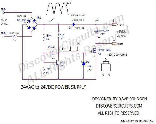

MM_Wombat
Joined: 12/12/2011
Posts: 139
Posted: 06:47pm 04 Mar 2016
Hi all,
Thanks for all the info.
The project is a drink dispenser, like at a fast food restaurant, that needed to be lit. Another company makes the dispenser and are already using a 24V AC PSU for the pumps. My company is printing the fascia's and lighting the device. My boss had already ordered the 24V DC leds strips, which have to be IP rated (liquid resist).
I found this circuit on DiscoverCircuits.com and will probably use this as it outputs close to 24V DC consistently, or so the author describes, to a max of 2 amps. His description was pretty much what is required.
Thanks again to all

Posted: 07:27pm 04 Mar 2016
  Quote   In either case you need a full wave rectification (gives 33.94Vdc ... with 1.4142 RMS figure)
Whether half wave or full wave rectification is employed, with enough capacitance the circuit will reach the peak voltage of the 24 volts RMS transformer which is about 34 volts. The only difference is that full wave will get to the peak with less capacitance (and the ripple frequency will be doubled of course).
Increased loading (if the cap isn't big enough) will result in progressively lower output voltage below the peak value.
The diode (in the hand drawn circuit employing 1/2 wave rectification) is desirable not just for the sake of the LED, but to prevent "power level" reverse polarity voltage getting to the single polarized filter cap.
Applying a reverse polarity voltage (unless it's just a current-limited, low level signal) to any type of polarized cap I can think of results in bad things happening pretty quickly, esp. with tantalums which often explode in those circumstances.
Another thing is that without the diode there would not be a steady 34 volts at the output. It would still reach 34 volts at the top of the AC sine wave excursion, but only for an instant.
HankEdited by HankR 2016-03-06

hitsware
Joined: 23/11/2012
Posts: 535
Posted: 01:26pm 05 Mar 2016
Duh .......... Looks like only diode and capacitor needed.
Perhaps ~ < 24V , but should work .....
Edited by hitsware 2016-03-06

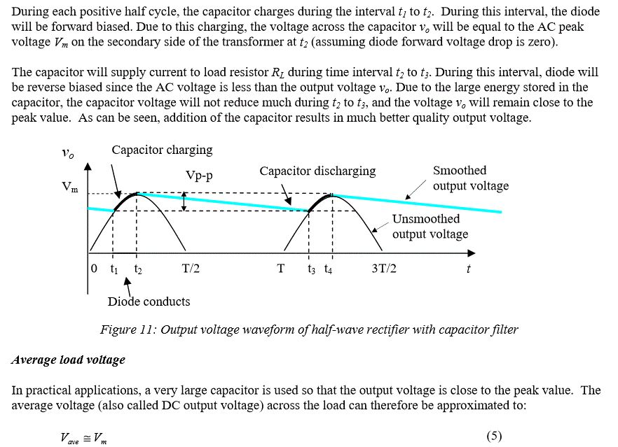

HankR
Joined: 02/01/2015
Posts: 209
Posted: 02:40pm 05 Mar 2016
  Quote   Duh .......... Looks like only diode and capacitor needed.
Hitsware,
Your graph and accompanying text amplifies on what I stated before. With adequate capacitance the filtered DC output (Vm) will be about 34 volts with varying degrees of ripple. There are also design charts available that show that amount of ripple specifically (normalized values) for different loadings.
Even with just raw full-wave rectified DC (no filtering at all), the voltage will be *above 24 volts* half the time, maxing out at 34 volts at the peaks.
So it's hard to not get 24 volts or above from a 24 volt RMS AC source. With adequately filtered DC, it all the time above 24 volts; with raw full-wave unfiltered DC it's above 24 volts half the time.
In your diagram resistance R should be removed because it could interfere with the quick charging of the cap to peak voltage (a small resistance R could be retained to limit inrush current when the power supply is switched on). The un-named resistor will serve to limit LED current.
MM_W, could you tell us how much total current the LEDs use? I see where you might have already settled on a circuit, but this will be instructive.
