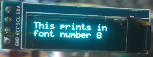

Posted: 11:33am 04 Mar 2016
Hi Peter
This font looks really nice on the small display (96x16)
Thanks for this.
These OLED displays have having an amazingly clear image
the photos do not do them justice
Jman
