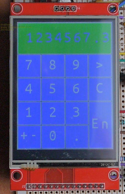

Nothing original but may be useful for those using the MM2 rather than MM+
This code demonstrates a function that draws a keypad on a 240 x 320 screen in portrait mode (2.8" ILI9341 in this example) and allows the user to enter any number up to 9 digits, signed or unsigned "+-", with or without a decimal point. It supports character delete ">" and cancellation "C"
I think I've programmed in most protections and tried to mimic the way a standard calculator input works.
After the ninth characters further input is ignored except the delete char key
Only one decimal point allowed
Decimal point not allowed as 9th character.
I've included the font I've used in the source.
The way the touch input works is deliberately slow (human time) to ensure there are no unwanted repeat character. This seems to work well and the touch is fully usable with a British Standard Index Finger - no need for a stylus etc.
All feedback appreciated.

Worked well for me too Peter on a 28 pin 170 and 2.8" ili9341. My settings a bit different. Note that you've got landscape orientation instead of portrait in the code above.
OPTION LCDPANEL ILI9341,P,4,5,24
OPTION TOUCH 7,9
As always, thanks for the handy program.
