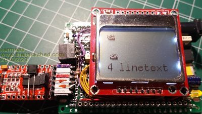

I have installed on my breadboard the NOKIA 5110 with PIC32MX170 and I installed this program CFunction NOKIA5110loadable.bas I've tried in two different breadboard and the result is the same. The only difference is that I use in DCpin, RSTpin y CSpin these other pines 22,21 y 23.
Then describe in detail the implementation process.
CPU …. NEW and LIBRARY DELETE. … ok
LOAD the NOKIA5110loadable.bas … ok
CPU .. Power OFF and Power ON … ok
The Cfunction is ON … ok
I write in Command Line (TeraTherm) dirctly … TEXT X,Y,” Micromite”
POS 0,0 … 0,11 … 0,22 … 0,33
Display definition 4X10 with de Font definition by defect
So far everything is correct
If I mount a program directly through the editor and RUN …
This is the result
This is the program.
'MODE TEXT in NOKIA5110 Display with this CFUNCTION
'NOKIA5110loadable.bas
Input "Text ",a$ 'manual pause
CLS
Text 0,0, "1 Linetext"
Text 0,11,"2 linetext"
Text 0,22,"3 linetext"
Text 0,33,"4 linetext"
CLS
If I stop in the program and manually type TEXT everything is correct.
QUESTION
what am I doing wrong ..??
Someone has happened .. ??
Possible solutions .. ??
Thank you.
A greeting.
David.

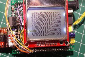

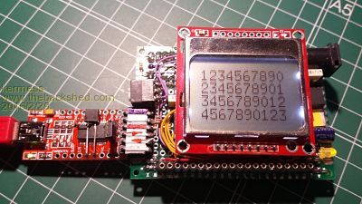

Posted: 03:08am 29 Feb 2016
This is a bug introduced because of a change in 5.1. Unfortunately it is quite a difficult fix. Please hang on and I'll post updated code ASAP
Posted: 04:26am 29 Feb 2016
David
Please try this new version.
[code]sub mm.startup
NOKIA5110(2,3,4,&HBb,1) 'DCpin, RSTpin, CSpin, Contrast, orientation
end sub

kermess
Joined: 04/04/2013
Location: Spain
Posts: 50
Posted: 07:14am 29 Feb 2016
Hi,
Fill the text screen, 10X4 CHR$ are 20 milliseconds .....
Four lines 10 CHR$
Perfect, guai,
Thanks peter, .... Phil the same
Gracias a todos.
David
kermess
Joined: 04/04/2013
Location: Spain
Posts: 50
Posted: 06:47am 02 Mar 2016
Hi Peter.
You can change the definition of text 10X4 chr to 14X6 chr .. ???
It is to get maximum data on this small screen.
If it is posible ....
Thank you.
David
Posted: 07:49am 02 Mar 2016
  Quote  You can change the definition of text 10X4 chr to 14X6 chr .. ???
No sorry, this is based on the size of the smallest font which is 12x8. Nothing I can do about this.
You could try using Jim's program to define a few characters in a 8x6 font as a test. None of us are sure if the MM firware will work with a font less than 8 wide. It would be a useful test for you to do.
If it does work there are 8x6 fonts available which would then just need converting
kermess
Joined: 04/04/2013
Location: Spain
Posts: 50
Posted: 02:30am 03 Mar 2016
Hi Peter.
I tried this program and the sources they have are perfect as they are in 14 chr X 6 lines.
2014-02-18_072256_Nokia5110Clock.zip
The drawback is that because so cfunction not be in the calling process to print text on screen is much slower.
Anyway thank you very much for your help.
I can work with the definition 10 chr X 4 lines
Un saludo.
David.Edited by kermess 2016-03-04

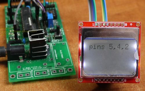

palcal
Joined: 12/10/2011
Posts: 2053
Posted: 05:05pm 06 Mar 2016
I have a project that uses a NOKIA5110 screen. I am using Jman's code but thought I would give this one a go. I loaded the code but can't get it to work, I read Embedded C Modules that comes with the Firmware distribution but having problems. How and when do I call the Csub and get text to the screen.
Paul.
Posted: 10:15pm 06 Mar 2016
  Quote  How and when do I call the Csub and get text to the screen.
Connect the normal SPI pins to the clock and data connections
Then edit the attached to use the correct pins for your application (DCpin, RSTpin, CSpin) and load it to the Micromite - and then reboot. The driver should report it is loaded when you reboot. You can then use all the normal graphics commands "TEXT", "BOX" etc. from the command line to test all is OK e.g.
TEXT 0,0,"Hello"
If all is well use "LIBRARY SAVE" then "NEW" and reboot again. The driver should report that it is loaded and you can then forget it and work on your application. It will automatically be loaded after every reboot until you do "LIBRARY DELETE"
sub mm.startup
end sub

Posted: 10:25pm 06 Mar 2016
  matherp said   . . . and then reboot. The driver should report it is loaded when you reboot.
This 'message' on reboot is very useful while 'debugging', however, in an end application it can be 'annoying' to see this 'techie' message.
Is there a way to have a 'switch' to enable/disable this startup message e.g. is there something in the CSUB that if changed will prevent/show the message.
Just asking as you may simply say change a couple of values in your 'code' which I can simply do
Posted: 10:41pm 06 Mar 2016
  Quote  is there something in the CSUB that if changed will prevent/show the message.
Just patch out the message at the bottom of the CFunction with an equivalent number of 00000000

I get an error Pin 4 reserved on Startup. I have used these pins
NOKIA5110(5,4,2,&HBb,1).
Matherp's example uses
but pin 3 is SPI out which I have connected to DIN on the display.
Where am I going wrong.
Paul.
Edit. I'm using a 28 pin chip with V5.1Edited by palcal 2016-03-08
Posted: 11:17pm 06 Mar 2016
  Quote  I get an error Pin 4 reserved on Startup.
The load program can only be run once as it allocates the pins and then you get "reserved" errors
Start with a clean MM. LIBRARY DELETE, NEW, no OPTIONS (use the !!!!! to do this)
Then upload the driver and reboot - nothing else. At this point the driver will work if your pinout is correct. You never need to call anything again to do with the driver - just use the normal graphics routines
My pinout was for a 44-pin where pin 3 is not allocated to SPI but your pins should be fineEdited by matherp 2016-03-08
