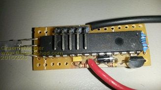

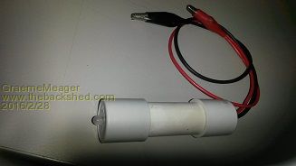

As I have about 10 vehicles with a lead acid 12 volt battery and some of them are used infrequently, I wanted a simple way of monitoring the battery at a glance to be warned when they needed a charge. I thought of analogue meters and LCD/LED readouts but they are limited with costs, battery drain and the need for close up inspection.
Given the Micromite can be set in a very low power mode I investigated a simple method of reading the battery voltage and flashing an LED for a short duration to indicate the voltage. I settled with a red/green/amber high efficiency LED that can be pulsed for 2mS and give a good amount of light to be noticed over a few meters distance. I chose to flash green if the terminal voltage was above 12.5 volts and red below 12 volts with the area between a graduated orange (from more green to more red). The circuit will draw less than 100uA per if averaged over time (even though the LED is operated at over 20mA it is only for a very minimal time). The current draw is minimised by using a low quiescent current 3 terminal regulator. Only a handful of components are needed to complete the circuit and I managed to simply encapsulate the unit in a short piece of 18mm conduit to protect and insulate the unit. I found a 2 milliseconds flash from the LEDs that I used was adequate but the length of the flash may be altered dependant on the power of the LED.
Here is the code I have used.
'* THIS PROGRAM WILL MONITOR THE STATE OF A 12 VOLT BATTERY *
'* AND FLASH A TRI COLOR LED.GREEN For >12.5V, AMBER BETWEEN *
'* 12 And 12.5 V And RED BELOW 12V. *
'* USING THE MCP1703 REGULATOR CURRENT DRAW IS MICROAMPS/HR *
'* MMBASIC 5.1 For MICROMITE II WITH OPTION AUTORUN ON *
'* THANKS TO GEOFF GRAHAM FOR ALL OF HIS WORK FEB 2016 *
Option EXPLICIT
Dim BLNK,CAL,VOLTS,URG
SetPin 14,DOUT 'RED LED ANODE
SetPin 15,DOUT 'GREEN LED ANODE
SetPin 23,AIN '10K/100K RESISTOR DIVIDER
BLNK=2 'LED PULSE LENGTH IN MILLISECONDS
CAL=11.26 'ANALOG CALIBRATION
START:
PAUSE BLNK+1 'WAIT FOR LED ACTIVITY TO CEASE BEFORE SLEEP
CPU SLEEP 3 'PUT UNIT TO SLEEP FOR APPROX 3 SECONDS
VOLTS=0.6+Pin(23)*CAL 'CALIBRATED FOR RESISTOR DIVIDER & PROTECTION DIODE
URG=1+(VOLTS-12)*2 'URG MANAGES THE AMOUNT OF RED/GREEN MIX
Print VOLTS 'USED TO CALIBRATE DIVIDER
If VOLTS > 12.5 Then Pulse 15,BLNK 'FLASH GREEN
If VOLTS > 12 And VOLTS < 12.5 Then
'FLASH AMBER
Pulse 15,BLNK
Pulse 14,BLNK/URG
End If
If VOLTS < 12 Then Pulse 14,BLNK 'FLASH RED
GoTo START

What an excellent project. Great work Graeme! I love the enclosure too. Have to keep that one in mind.

Nice job Graeme - as Jim said, simple and effective. It's very compact too and the code couldn't be more succinct.
Greg

Pretty clever using pins 14 and 15 so the led is right next to the pins at the end. A neat little project.
It probably would not make a lot of difference as its asleep most of the time, but you could consider running the CPU at 5MHz to save a bit more power.

  Quote  It probably would not make a lot of difference as its asleep most of the time, but you could consider running the CPU at 5MHz to save a bit more power.
Gerry I did try running the CPU @ 5Mhz but I couldn't see any measurable difference. I left it at full speed as I thought that it would pulse both LEDs virtually simultaneously to get the amber colours, even though there are two commands:
Pulse 15,BLNK
Pulse 14,BLNK/URG
Thanks for your comments.
