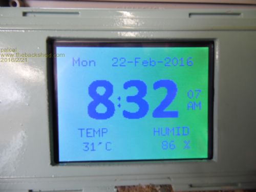

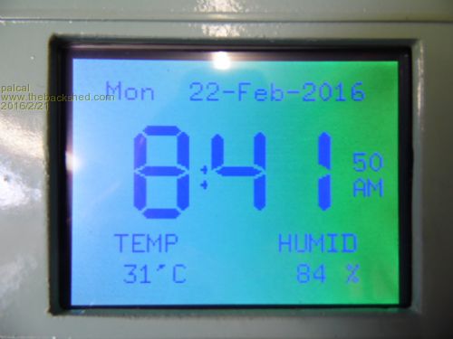

I am using the seven segment number font from here
Unfortunately the number 1 appears smaller than all the other numbers and does not look good. Is there anyone (maybe matherp) that could look at the file and make the 1 slightly larger.
Paul
edit. the 1 is also printed with the two right side segments which leaves a space between it and the previous number is it possible to move it to a mid position
the number 4 is also smaller
Hope this is not too much to ask.Edited by palcal 2016-02-22

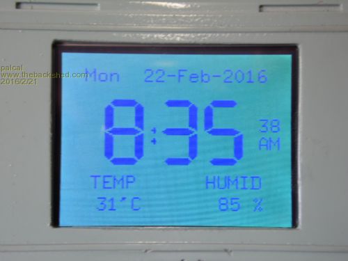

I see what you are talking about, but even though 1 and 4 are slightly smaller, this is correct for the 7-segment font in question - look at the layout of the unlit segments with respect to numbers 1 and 4.
'segment18_XXL' font has more uniformly sized digits - further down the same page.
That, or any of the 16-segment fonts......

I realise that but when the top segment is on the width of the segment makes that number larger. I also tried the 16 segment font but like the 7 segment one much better.

Try replace the data for the 1 with this and see what it looks like:

Looking at the code for the font, I don't know what code is for the 1. The code is not commented.

In the original code, each character is on one line. The comments are waaaaaaay over to the right. So replace the second data line with the stuff I posted above. You can edit what I posted back to just one line if you prefer. I just didn't want to post a code block that was some 1000+ characters wide.

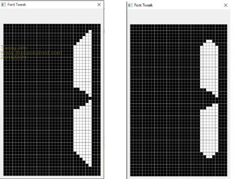

Posted: 08:46pm 20 Feb 2016
I understand what you are asking for.
There are some 7 segment displays that use more of the corner.
I have started on a program to enable fonts to be tweaked (or created from scratch.
The image on the right is from SevenSegNumFont.c and the image on the left is a modified one.
Is that likely to be sufficient (while still complying with the seven segment purists) or would you like more tweaking.
I should be able to give you a modified font in a day or two. The full program will be a bit longer...

Posted: 08:54pm 20 Feb 2016
Thanks Jim that's getting there,can you retain the pyramid shape on top and bottom and fill in the middle a bit, also can you align the 1 in the centre of the grid.
The four also needs attention.

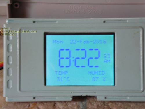

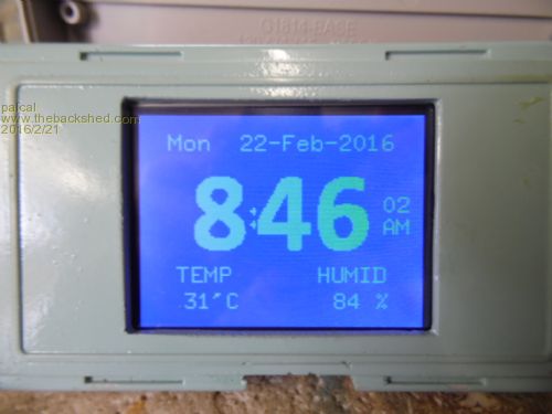

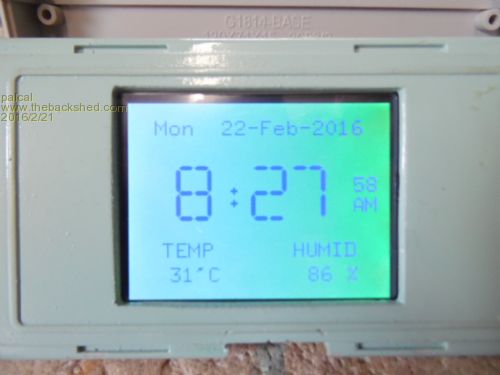

Posted: 01:30pm 21 Feb 2016
I have converted some fonts(switched to a 64 bit machine). These are some pics. not very clear though. As you can see by the time,temperature and humidity I live in the tropics in North Qld.
SixteenSegment 64x96
SixteenSegment 48x72
Calibribold.
SevenSegNumFont
SevenSegNumFont small 4 and 1
Calibribold colours reversed by touch screen
The screen can also be dimmed by touch for night time.
I have settled on Calibribold if my Grand Daughter agrees, the clock is for her
It is GPS by the way, with a DHT22 temp/humidity sensor.
Paul

That looks great Paul - I like the SevenSegNumFont too. The GPO wall plate mounting idea works pretty well too (who was it did another one six months or so ago?) I was at Master's hardware here last weekend and they've got a big range of GPO wall plates that include several fancy modern looking designs, much more so than the standard white Bunnings HPM-type ones. Some are polished or brushed metal, some specially edged etc. - they'd make good mounting options too.
Are you going to release your code, and also how are you going to power it - wall wart?
