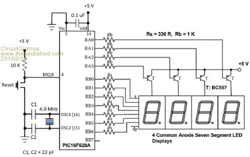

CircuitGizmos
Joined: 08/09/2011
Posts: 1427
Posted: 10:27am 19 Feb 2016
The PIC16F628A in the sample schematic is a microcontroller just as the MicroMite is. You can connect the 7-seg displays like the schematic shows, using pins from the MicroMite instead. You would have three displays rather than the 4 shown.
The schematic is for Common Anode displays. Similar schematics can be found for Common Anode 7-seg displays.
As a reference in the diagram above selecting one of the displays is done by selecting one common anode line (RA0 to RA3) and setting the RB0-6 lines to illuminate the correct pattern of LEDs. Each 7-seg is individually selected and the pattern for that number is output on the RA lines.
Again your lines on the uM wouldn't have the RA and RB designations, but would perform the same functions.Edited by CircuitGizmos 2016-02-20
