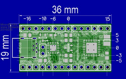

As my quest for PCB assembly is not going well i decided to start building some equipment to help me place SMD parts.

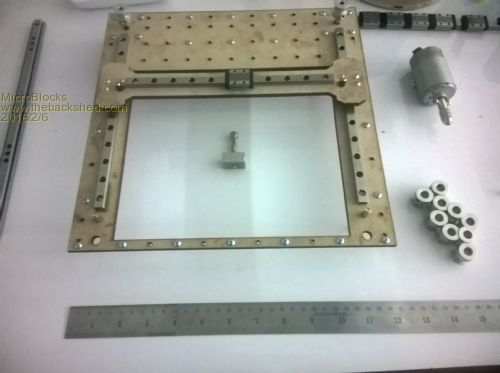

The first thing i used is a X-Y stage i took out of one of my home made 3d printers.
It is based on a CoreXY stage that is described here: http://corexy.com/
I am going to mount a small SMD tool that can be moved slightly up and down and connect a foot pedal to control a vacuum. Still have to find a good one that has good suction cups. Also a USB microscope so i can place the part accurately.
The idea now is to mount this on a base plate that has holes drilled spaced 2.54mm apart so that it can be used to align pcb's that have pins on a 0.1" grid.
To help with accuracy i use a stop that can be locked in 1mm increments. I designed my board with that in mind so that i can base all the coordinates from an origin.
In this case i place a supervisory chip on coordinate 0.0 and it also has a silkscreen grid drawn so that all intersections where parts are place have a crosshair to help aligning.

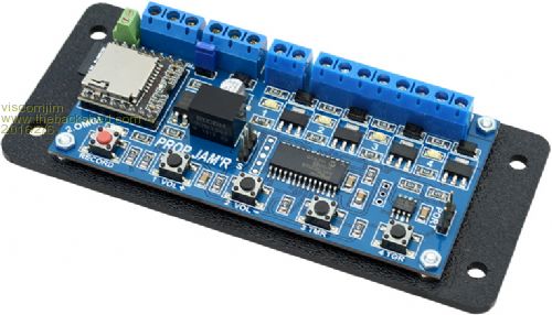

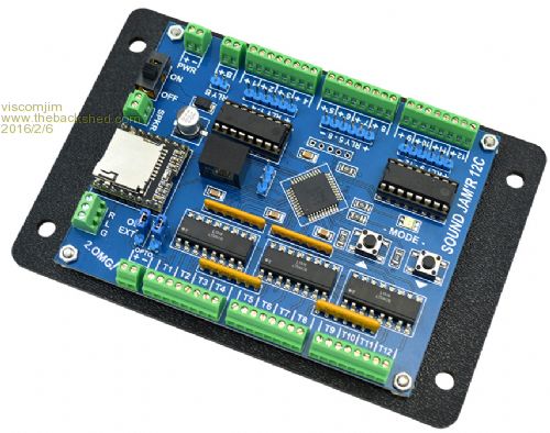

Hi MicroBlocks, I have two uMite boards that use surface mount components. These are the very first two boards I have ever had made and my first attempt in surface mount. I did a lot of reading on the web and wound up using an aquarium pump with the pump reversed so that it became a vacuum. Using a pen with a syringe needle, I can easily pick up the parts and place them by hand on the board. The pen has a small finger hole that I use to open and close the vacuum.
HERE is a video of the vacuum pump idea.
I have gotten quite good at this and am able to produce boards 5 or so at a time and then take them over to my reflow oven in the garage and bake them. I am using a cheap black and decker oven with the zallus reflow controller and have yet to have a board that didn't work.
The board manufacturer, shenzhen2u, has a great deal on stainless steel solder stencils when you order your boards. For $18.00 this is a no brainer, and has worked flawlessly for me. I highly recommend.
Here are what the boards look like...
As you can see, on both boards there are thru hole components, especially the screw terminals. I just recently purchased a solder pot big enough to dunk the boards in and do all the soldering of the thru hole parts at one time. I haven't done this yet, but on my next boards, I will fire this up and hopefully it will work well.
