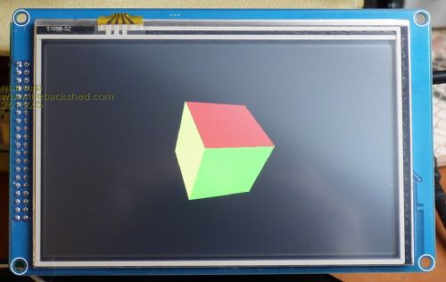

Warning: this code is completely useless
But I think it is interesting
In this thread we looked at using the mathematical technique of using quaternions to manipulate wire-frame objects in 3-dimensional space.
This post takes that further by using some of the techniques of 3D graphics processing to manipulate and display solid objects.
Watch the video
To do this we need to implement Hidden Surface Determination . In the code below we use Painter's Algorithm
In general computer graphics uses triangles as the basic drawing object. In this example each face of the cube is split into two triangles and a standard fill-triangle algorithm used to draw them.
The vertices of the cube are manipulated in 3D in the same way as in the previous post. However, in this example we also manipulate the centroid (geometric centre) of each face of the cube. By doing this we can calculate the distance away of the centroid along the Z-axis after each rotation. This allows us to sort the Z-position of the centroids and display each face in turn, furthest away from the viewer first. This implements the Painter's algorithm which works extremely well except when faces overlap as shown in the Wikipedia article.
The code is all in Basic except the floating point sort and the triangle display functions.
Drawing has been deliberately slowed to see the hidden surfaces being overwritten by each face as they are drawn in increasing order of Z axis.
The code as listed runs on a SSD1963 800x480 display but will also run on a ILI9341 but you will need to adjust the "scale" to fit the screen (300 works well). It will run on uM2 or MM+.
I hope this is interesting insight into the way objects can be manipulated in 3 dimensions and then displayed on a 2D screen

Kind words but this demo is closer to awesome

The source is in this thread
Note it will only run as-is on a 4.3" SSD1963 display using the special loadable driver. With minor changes it will run on any display but you will get a lot of flicker. The paged memory technique on the 4.3" SSD1963 eliminates this.Edited by matherp 2016-02-06

Will be trying on a 2.8" ILI to see what the speed is like. Thanks for this . . .
WW
EDIT: Just seen that the 'fast' version only runs on a SSD 4.3 Edited by WhiteWizzard 2016-02-06
