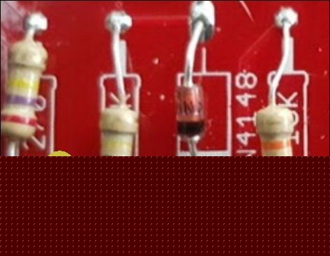

The 1N4148 diode in the photo may not be soldered on the bottom leg. I don't have a circuit so I have no idea what effect that may have.

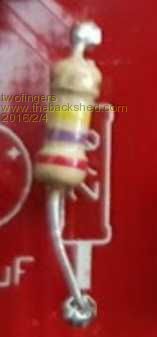

it also looks like you have a 270k resistor in series with the output to the clock module (red-purple-yellow). this should be 270 ohm (red-yellow-brown).
the 270k resistor will ensure the hands can not move!
rob :-)Edited by robert.rozee 2016-02-05

Maybe red-violet-brown for 270 ohm ?
Posted: 03:51am 04 Feb 2016
oops, you are right, 270 ohm is indeed red-violet-brown (red-purple-brown)
rob :-)

The diode although it looks not soldered, is soldered underneath the board, however I will redo it when I get up in the morning

  lew247 said   [...]The resistor I actually measured it with a meter and it's 269 ohm
Are we talking about this resistor? That's astonishing!
Are you a b s o l u t e l y sure?
In addition I would inspect all solder points. Good luck!
Michael Edited by twofingers 2016-02-05
Posted: 06:05pm 04 Feb 2016
just for my own piece of mind, could you possibly check the resistor again? making sure that the clock module is not plugged in when you do the check.
that multiplier band really looks like it is yellow, and not brown.
rob :-)
BobD
Joined: 07/12/2011
Posts: 935
Posted: 06:27pm 04 Feb 2016
  robert.rozee said   just for my own piece of mind, could you possibly check the resistor again? making sure that the clock module is not plugged in when you do the check.
rob :-)
rob
In the picture below I have sampled the colour bands on each resistor with a colour picker. I then pasted each sample onto the image. You can see the effect. The band on the left hand resistor did vary a bit from light yellow to a mustard colour depending where the sample was.
bob
edit: I updated the image to show the yellow range.
Edited by BobD 2016-02-06
