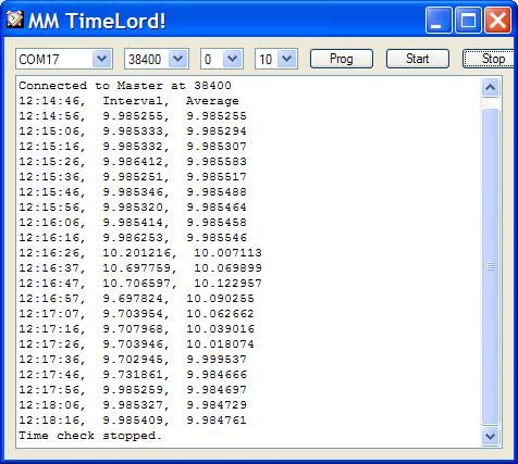

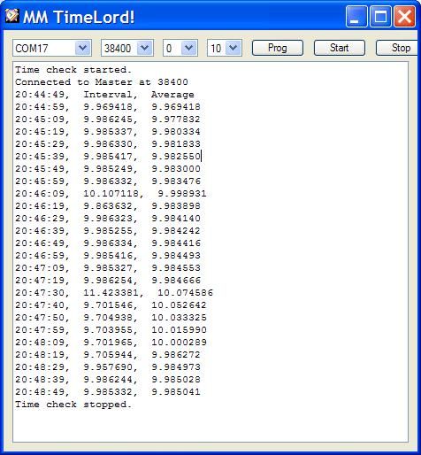

Jim - just gave this a go on the old XP system and got the data below connected to Mik's SMD Backpack running V5.1. It was connected via USB and the FTDI chip on the backpack.
If you look down the data to time 20:47:30 you can see a bad result (big Interval/Average difference compared to most of the others). That came from me adjusting the size of the XP window as it was running. There are a few directly below it too that are anomolous which were caused by me leaving the cursor on the box edge - it went back to normal differences after I moved the cursor. Looks like you can't play with your PC when you're collecting your data.
I looked at my differences too compared to your results and it's obvious mine has a poor precision. I wonder if that's because of my old slow XP system, or something else?

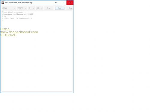

Jim,
I get nothing! If I start TimeLord and click [program], then [start] this is all I get :-
This is after at least a minutes wait.
Rob

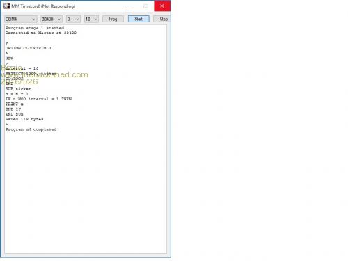

Sorry image is poor, can not copy text as locked! I need to find a better way than Alt Print screen and paint.
Not sure why the program did not show program - perhaps here's my problem!
I have seen the tilder character and the message when ever I start TT with the MM already powered, I have always ignored this!

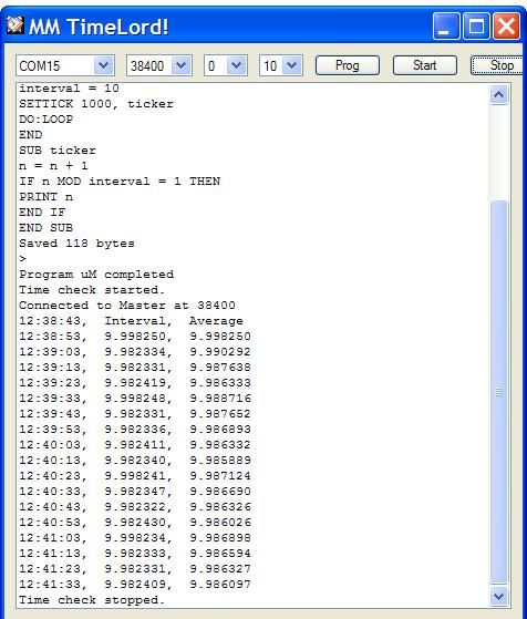

  TassyJim said
After the strange results (slow) we were getting with FTDI, I would be interested to see a comparison with a different chip and your PC.

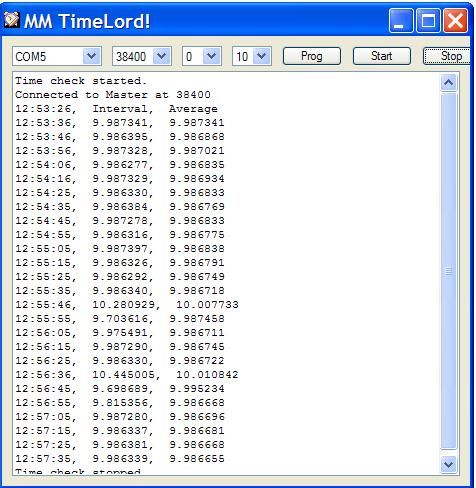

OK, sure looks like FTDI (or their clones??) are a problem. Just repeated it on Mik's MUP with network disconnected (so no external interrupts?) and with MUP's on-board FTDI and got this below. Note the jump to 10 secs and bad results when I fiddled with window size again. It also takes a long time to come back to 'normal' - I wasn't fiddling after the first two 10 sec bad results.
Then tried a standalone FTDI converter on a DIP 170 and got this. Pretty much the same crappy results - it 'looks' better because I didn't fiddle with the window size.
Then tried a PROLIFIC converter (in a DKU-5 moulded cable - but the device manager does say it's Prolific), and got this.
One hell of a lot better! I had another window size 'fidddle' at 55:46 and 56:35 to see if that still affected it - and it does.

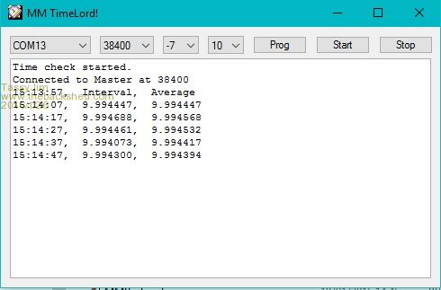

Glad to see it working at last. A CLOCKTRIM of -2 tells me you are in a warmer climate than me.
'-2' is also easily close enough for the pic32prog flashing program to work reliably but it could be a compatibility problem with the chipset.

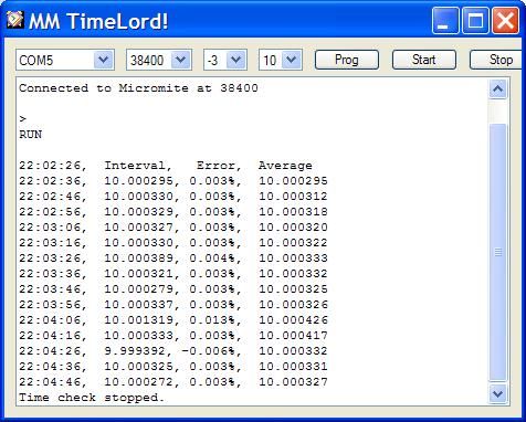

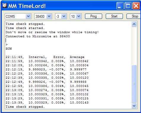

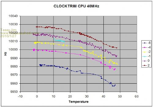

Posted: 06:55pm 26 Jan 2016
When we first had CLOCKTRIM added to MMBasic, I did a few tests.

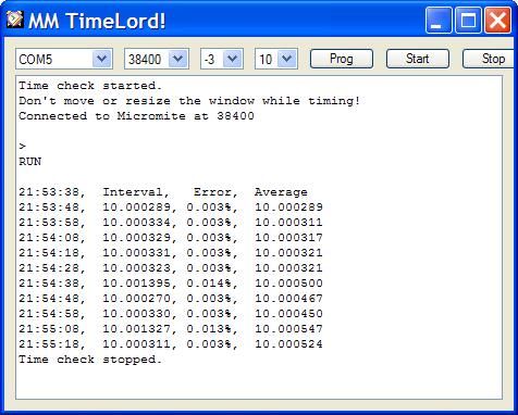

I have made a couple of changes to MMTimeLord.
There was a bug if you tried to use an update interval other than 10 seconds.
I have added a percent error column to show that the default is still pretty good.
Time check started.
Don't move or resize the window while timing!
Connected to Micromite at 38400
RUN
15:33:17, Interval, Error, Average
15:33:27, 9.961318, -0.387%, 9.961318
15:33:37, 9.961322, -0.387%, 9.961320
15:33:47, 9.961193, -0.388%, 9.961278
15:33:57, 9.961716, -0.383%, 9.961387
15:34:07, 9.961298, -0.387%, 9.961370
15:34:17, 9.961341, -0.387%, 9.961365
15:34:27, 9.961575, -0.384%, 9.961395
15:34:37, 9.961323, -0.387%, 9.961386
15:34:46, 9.960933, -0.391%, 9.961335
2016-01-27_045406_MMTimeLord.zip

When I did the temperature runs, I used a maximite to measure the frequency being generated by the micromite. That worked well but needed extra wiring.
We are still only using an oscillator of unknown precision (in the PC) for our reference, so I am happy with the result. I need to compare a few different PC's to see what variation I get but don't want to get too hung up on the results.
