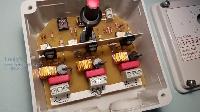

3-phase can definitely be done. Here's a little 3-phase fan controller I built overseas back in 2003 using triacs. The customer refused to have single phase exhaust fans in his factory. I made up half a dozen of these for proof of concept. The circuit is bare bones and absolute minimalist based on a PIC12C508A, an 8-pin OTP microcontroller, which was the cheapest PIC available at the time. That's it hiding behind the knob.
Some info:
400VAC 3-ph 50Hz 2A full-wave, half-controlled, no neutral connection.
Operates with either forward or reverse phase sequence
Loss of phase protection (which could cause motor burnout)
Minimum speed trimmer
Link for connecting a thermo-switch (motor protection)
Triacs are 800V 12A isolated tab types
White ICs are opto-triacs
Software is in Assembler.
Controllers were still operating when I enquired two years ago.
Project discontinued when stricter EMC requirements came into force that year and anyway I was returning to Oz.
I wish I had a Micromite back then. That PWM enhancement by Geoff makes it perfect for this application.

Hi Louis,
Are they MOC3021 devices hiding in plain sight there?

Posted: 12:43pm 23 May 2018
Probably the white thingies behind the heatsink. Then again, they could be something else
