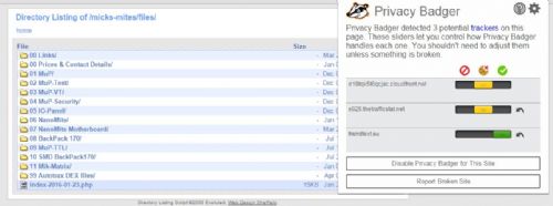

Here's what I get:
I also get the occasional Popup page but it gets killed by the Browser/ABP befor it has a chance to load any content.
That image is a bit small the relevant info is:
Privacy Badger detected 3 potential trackers on this page. These sliders let you control how Privacy Badger handles each one. You shouldn't need to adjust them unless something is broken.
d19tqk5t6qcjac.cloudfront.net
s925.thetrafficstat.net
trendtext.eu
Chris
Edited by Chris Roper 2016-01-27

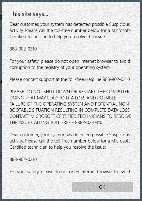

Got this this morning : Edited by hitsware 2016-01-27
hitsware
Joined: 23/11/2012
Posts: 535
Posted: 06:32am 26 Jan 2016
  hitsware said   Got this this morning :
(image upload not working)
hitsware
Joined: 23/11/2012
Posts: 535
Posted: 06:53am 26 Jan 2016
Chris Roper
Joined: 19/05/2015
Location: South Africa
Posts: 280
Posted: 08:51am 26 Jan 2016
That one is particularly nasty ........
Blatantly obvious Social Engineering, for most of us, but would terrify any novices, certainly my parents and their friends.
http://caroper.blogspot.com/
hitsware
Joined: 23/11/2012
Posts: 535
Posted: 09:02am 26 Jan 2016
That's putting it politely ...
