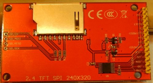

I have a 2.4 tft spi lcd ILI9341 which I cannot get to go just a white screen
It does not respond to anything that works on a 2.8 tft lcd even if I redo the setup for lcd panels and touch, nothing.
The back of the unit is very similar to the 2.8 unit except their is an extra transistor Q1 and two resistors R5 and R6.
Any ideas??

Posts: 12081
Posted: 11:21pm 12 Jan 2016
Cliff
Can you post a detailed picture of the PCB?

matherp, here is a picture of the back of the display
KRZ3, resoldered the pin header no joy.
The display works sometimes cycle the power it is ok unplug it and replug it wont go, try that with the 2.8 display never fails.
A bit of a nuisance.
Cliff
