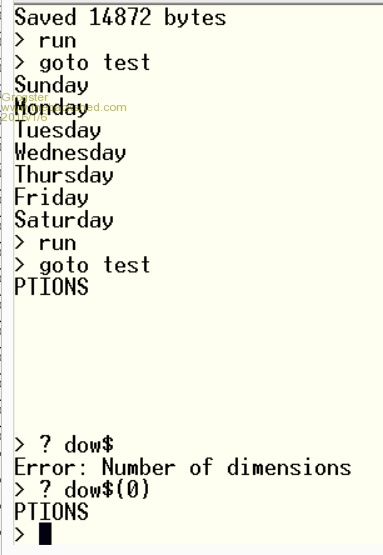

UPDATE:
Here is an image I get on the terminal, which shows the results of DOW$ after two run cycles.
The extra testing code is:
test:
For X=0 To 6
Print DOW$(X)
Next
End
...and the results are:
First time 'test' is run, I have stopped the code before pressing any GUI button.
Second time 'test is run, I have pressed the DATABASE button.
Note that DOW$(0) now seems to contain text from GUI button #2......
(that being OPTIONS without the O at the start)
Posted: 11:46pm 05 Jan 2016
Looks like GUI is corrupting memory.

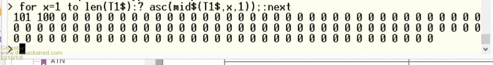

I've just tried to define two strings - T1$ and T2$ so I can use these in the GUI caption command, and am having EXACTLY the same issue, in that T1$ and T2$ are blank when you try to call them, so this is a totally different routine to what you mention disco4now, but they could still be related in some weird way.
The code I am trying to use in another screen is:
DateAndTime:
CLS
GUI delete all
Font 7,3
GUI caption #10,"DATE & TIME:",100,25,,RGB(yellow)
'Line 100,75,650,75,3,RGB(yellow)
Font 4,1
T1$="Touch numberboxes to enter data, and then"
T2$="touch the OK button or the << button to exit."
GUI caption #11,T1$,50,100,,RGB(green)
GUI caption #12,T2$,50,125,,RGB(green)
'Text 50,100,"Touch numberboxes to enter data, and then",,4,1,RGB(green)
'Text 50,125,"touch the OK button or << button to exit.",,4,1,RGB(green)

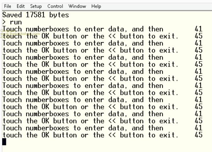

As soon as you try to draw the caption, T1$ and T2$ are blank with a length of zero, despite just being defined. If I put an END command between the T1$= and T2$= lines and the GUI caption commands, then ask the console to print them, they print.
Caption #10 works fine, as I am defing the text as part of the command itself, but captions #11 and #12 make the line too long for the editor, so I put them in strings first.

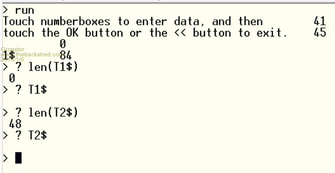

Posted: 02:42am 06 Jan 2016
UPDATE:
Yep, something very odd going on here.
New quick test code:
Font 4,1
Print T1$,Len(T1$):Print T2$,Len(T2$)
Result on the terminal:
I'll wait and see what Geoff says about all this before I get too carried away posting any more stuff about this.

I have found an even faster way around this issue, thanks to disco4now giving me an idea.
The problem seems to be related to the LENGTH option on the DIM command.
If I replace:
Dim MTH$(12) LENGTH 3
Dim DOW$(6) LENGTH 9
...with:
Dim MTH$(12)
Dim DOW$(6)
Then EVERYTHING works just fine - day references, captions - all that was not working before.
I think we may have stumbled on the cause - the LENGTH spec?
Output from terminal with many cycles through the code:
...everything perfect.

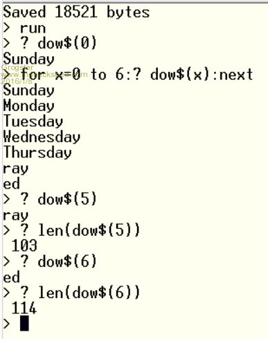

We're still getting corruption within arrays:
Note that DOW$ elements 5 and 6 are now more then 100 bytes long, when they should only be single words...
For the above image, I copied the rogue element into another string first during playing at the cosole.
I will wait and see what happens when v5 comes out soon.
EDIT: ...and yet more corruption...

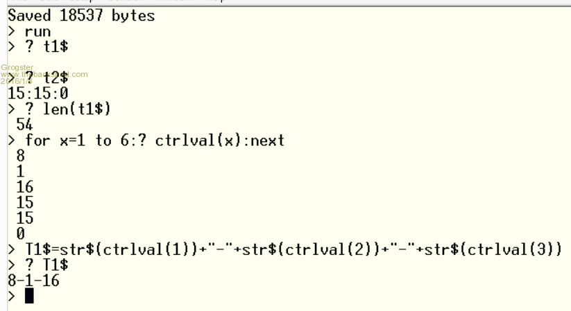

Here is more of this error, this time when I tried to use spinbox values to set the internal RTC:

If I try to run this the string generated for T1$ is corrupted.
It is NOT corrupted, if I manually issue the exact same code at the command prompt.
