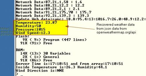

JSON weather data from http://openweathermap.org/
uMite routines snippets to parse data received from ESP8266 running ESP Basic.

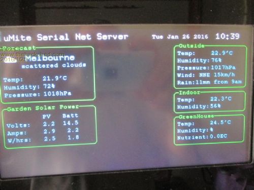

Hey Jim, Thanks for your interest!
Today is Australia Day and I am President of the local community group so have so things to do until later in the day. Later today I will post some updated code, things have moved on somewhat! 7" LCD Weather from OpenWeatherMap.org , local data comprising of weather station, Greenhouse, house temp/hum and garden solar power.

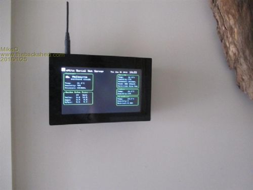

Hi Jim, sorry for the delay, I have now posted all my latest code on my website if you want to take a look here.
There is also a direct live link to the ESP8266 web page , I don't think its the most robust interface but its working, showing live data from my sensors. I am please with the UMite Plus part of the project , it works great , thanks to Geoff!
It interfaces nicely with the ESP8266 fetching NTP time updates and weather forecast data from Openweathermap.org. See previous post. Enclosure by the way was purpose built to fit the 7" SSD1963 LCD from black acrylic on my CNC mill, then parts glued together. Some sensor input "fixing" , I have noticed some are missing, is next then interfacing the data to IOT primarily to monitor greenhouse sensors.
