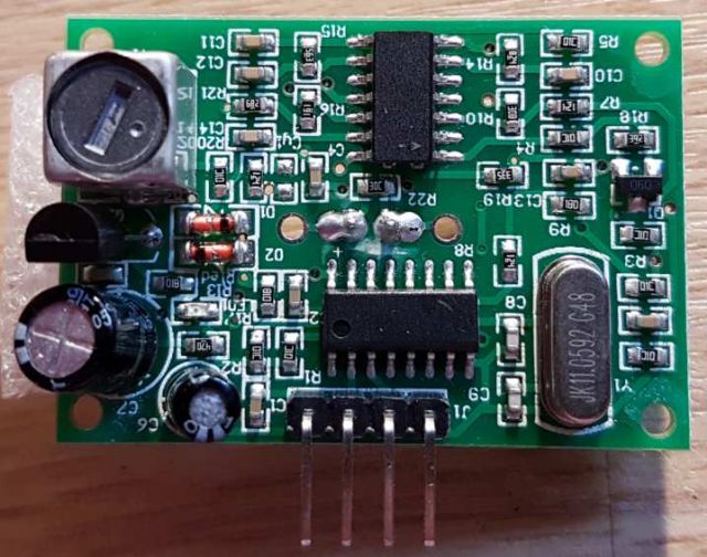

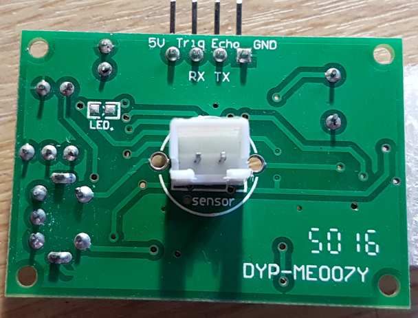

This is the link for them from ebay and the controller looks the same as the one you posted originally.
Here are some close-ups of the board - the two ICs are un-marked (of course)
Initially I expected them to be PWM devices. I bnotice the tiny green LED flickering as soon as they got power, wrote some code with the Distance CSUB and got a stream od -2's with the occasional 16.7 or similar... took the device out and replaced it with the test "twin can" stylee and the code worked immediately.

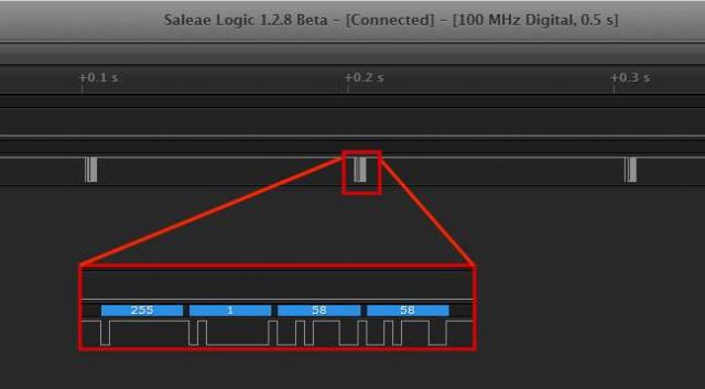

Got my analyser on the teo pins and saw the trigger pulse seemed to have nothing to do with the echo pin... stopped the code and the pulse train continued. Zooming in, it looked familiar so i applied a serial analyser and got the previous screen shot on one of them.
I chaged the code and linked the "exho" pin (which is also labelled TX) to COM1 and wrote some code and got this from it:

I have done a bit more fiddling with this and I have come to the conclusion that the output is a direct reading of milimeters.
Let's call the four bytes S,a,b,b' (Sync, a,b and b prime)
S=255, always. b' is always b +/- a few
I have a rough correlation of a*256 + ((b+c)/2) as millimeters (I actually converted to cm just to stabilize the readings a bit). It definitely seems to be giving in the right area.
sometimes (haven't been able to pin it down yet) the sensor drops to around 40cm and then that is it - I have to power cycle the unit to get it back - the trig input doesn't seem to do anything HI or LO but then I suspect it is just the RX input on the micro-controller near the plug.
It seems like it is some sort of time-out. I have seen times of 82 seconds and another of 177... if this is aimed at the automotive industry it may be a way of drawing attention to the vehicle left in reverse for a prolonged period.
