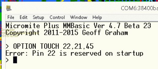

What does this mean, other then the obvious?
Reserved by what?
Clean flashing of firmware, the only thing I have done since power-on, was to issue the LCD command: OPTION LCDPANEL SSD1963_7, L, 4. I then cycled power as instructed, and then issued a GUI TEST DISPLAY command to check that the LCD was happy, which it was.
Pin 22 is only routed to the touch CS, and nothing else.
Manual does not say anything special about pin22 in the pinout diagram.
Any ideas people?

I just tried your OPTION TOUCH 22,21,45 command on my MM PLUS and received a "restart Micromite" response.
Mine is at Beta 37, yours is at 23.
Posted: 02:50am 30 Dec 2015
I must be using an old beta then.....
I will have a hunt around for B37 - so many revisions to keep track of!
