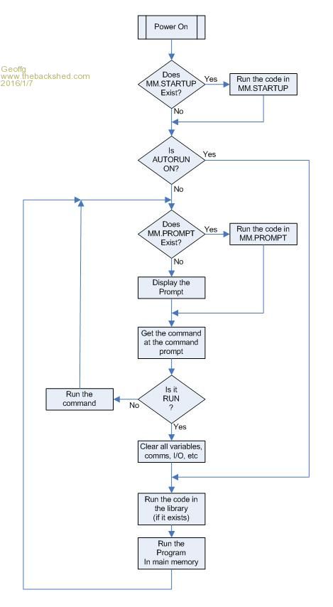

OK, I have spent some time going through WW's post above, ie:
  Quote  POSSIBLE FIRMWARE BUG?
A lot of the problems seems to arise from testing library functions at the command prompt. The important thing to note is that the library code is only run immediately before the program in main memory is run. It is not run when the command prompt is displayed.
The way that the interpreter runs startup code can be best illustrated with a flow diagram. The actual process is more complicated but this is the high level summary:
I have gone through WW's step by step process and MMBasic does what it should. So the issue might be a misunderstanding or perhaps I have fixed the issue while fixing other bugs in 5.0. I believe that the best way forward is to wait for ver 5.1 (due out in a few days) and see if the issue persists.
Edited by Geoffg 2016-01-08
