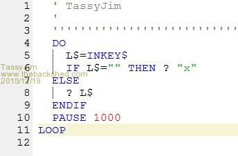

Posts: 6631
Posted: 10:05am 19 Dec 2015
Code verification is something that I have considered in MMEdit.
I found it difficult to be sure that my idea of correct is the same as MMBasic's idea of correct/acceptable.
For now, using the code format tool highlights some likely suspects for errors.
In this case:
The DO ... LOOP doesn't line up.
I find the indenting invaluable as a quick check in MMBasic as well as Liberty Basic and PureBasic, my two 'other loves'.
