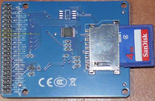

Hi there everyone, but especially matherp.
Have you, or anyone else for that matter, developed a driver for this LCD module by any chance?
This one appears to 8-bit parallel with touch for US$7.50
Also has uSD card slot, and on-board video RAM, which is an interesting twist.
It is in Arduino Shield footprint, but also looks like the connections are routed out to a 2x9.
I would be prepared to purchase and send this LCD to matherp, if he would be interested in developing a driver for it.
It would seem it uses the SPFD5408 controller chip, the datasheet for which can be found here .

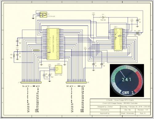

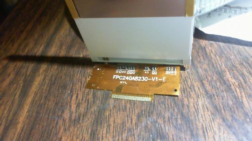

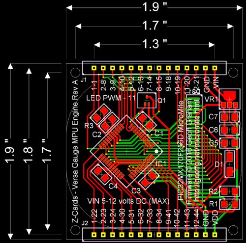

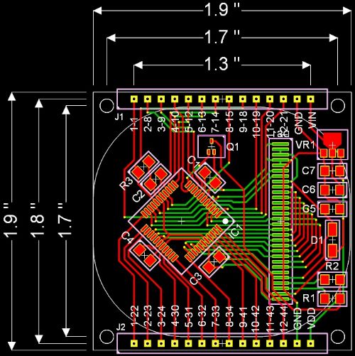

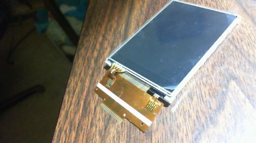

I just received 10 of these "raw" displays from E-bay and they say it's the ILI9341 graphics driver... However, after asking the seller for some info and pin-outs data, looking at the "English" PDF file, it says it's the ILI9325 controller... Sure is a good thing you have code for both..!!
I want to create a PCB with a FFT connector to interface to this unit, making the thinnest MM touch PCB possible... I will be adding a Rs-485 comms interface to use it as a "setup controller" for the telemetry module for the EIS system... The telemetry module will be housed into a "potted" module for toughness and can't have a glass display in it as originally planned... So, since the main system data transfer buss is going to use Rs-485, I wanted to add this unit on as a slave so the end user can do the setups easily without resorting to a PC and having to setup Teraterm..Ect...
I know I will need to add a touch controller in to the design also...
I will also make some kind of interface to bring out the MM pins...
Still looking for the pinouts.. Will update later... (go bed now)
