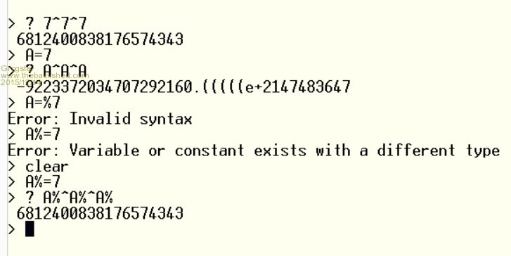

Posted: 12:43am 14 Dec 2015
@Geoff - possible bug v5.0 on 28pinner??
Wasn't sure where to post the following but it is linked to this thread's title talking about 'big' numbers.
If at the command prompt you type: PRINT 7^7^7
the answer comes back as: 6812400838176574343
BUT if you type: A=7: PRINT A^A^A
then the answer shows as: -9223372034707292160.(((((e+2147483647
Any number bigger than 7 'loaded' into A; and then printed as: A^A^A will give exactly the same -922..... result

What about if you type
A%=7: print A%^A%^A%
Posted: 12:59am 14 Dec 2015
matherp is right.
Ignore my typos that the command prompt reminded me of......
Posted: 01:01am 14 Dec 2015
  matherp said   What about if you type
Initially: "Error: Variable or constant exists with a different type"
Anyway: B%=7: PRINT B%^B%^B% gives the 6812400.... (correct) answer.
By the way, I am not 'needing' the correct mathmatical answer; just pointing out that the 'format' of the A^A^A result is 'incorrect'; and is also exactly the same for numbers > 6 for this example.
IMHO it would be better if 'number too big' could be displayed; assuming it is possible to 'trap'.

Posts: 12080
Posted: 01:10am 14 Dec 2015
  Quote  but note I am NOT after the answer
I was just explaining the discrepancy in your results
a=7 sets a as a float unless you have "option default integer" set, whereas 7^7^7 interprets 7 as an integer as there is no decimal point
print 7.0^7.0^7.0 gives your error which is one for Geoff to see if he can trap the overflow

Posted: 03:12am 14 Dec 2015
  WhiteWizzard said   I am now curious as to where '-9223372034707292160.(((((e+2147483647' comes from
It's a bug! Those parens are just some buffer corruption or the like.

Posts: 3369
Posted: 04:31am 14 Dec 2015
MMBasic does not attempt to check for arithmetic overflow. It would slow the interpreter too much and given the huge range of floating point numbers, would only occur in extreme circumstances - like those listed above.

Posts: 12080
Posted: 06:27am 14 Dec 2015
  Quote  MMBasic does not attempt to check for arithmetic overflow
Unless I'm missing something 7.0^7.0^7.0 = 6,812,400,838,176,574,343
= 6.812400E18
Which shouldn't overflow. "a=6.812400E18" works fine and "print a" reports the correct number
A bug in in the Microchip powf function?
Posted: 07:02am 14 Dec 2015
Done as (7^7)^7 the result is
256,923,577,521,058,878,088,611,477,224,235,621,321,607
About 2E41 I think - so beyond single precision's range.
Linux bc gives me a far larger value for 7^(7^7)
(goes off the screen).
JohnEdited by JohnS 2015-12-15
Posts: 12080
Posted: 08:52am 14 Dec 2015
  Quote  About 2E41 I think
That's interesting so the 64-bit integer version is also wrong but doesn't look as silly. I've just checked oon Excel and it agrees with your figure exactly
