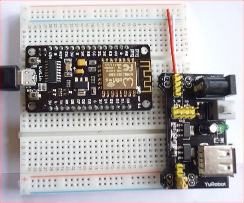

I also bought a nodemcu lolin example of ESP8266 as shown. The module unexpectedly stretches EXACTLY across the working surface of a breadboard, which seems the most ludicrous design a dip chip could have for a breadboard.
I have conquered that by butchering 2 mini boards as shown. I am proud of my ingenuity, and although I must be careful, the setup seems to work successfully.

Hi Barry, I am using this board also but there a different versions of this board right now. Could you take a look at the chip that is near the usb plug and let me know what the numbers are? These boards are coming out with at least 2 different usb to serial chips. This will determine which driver you will need.
I am on my way to work, but I will describe how I flash this board. I actually use the nodeMCU flasher to flash the espbasic to it. Hang in there a bit, I will get back to you!!!! I am glad to see you are not giving up.Edited by viscomjim 2015-12-03

I also have a NodeMCU v0.9
I noticed it is too wide for a single proto board. I also do not like the fact that you need to push the reset/flash button every time you try to compile/load something in the arduino IDE.
I recently received the v1.0 of the nodeMCU. It has the square USB chip instead of the rectangle. The board is narrow and you get proto board holes on each side. It also does not require you constantly push reset/flash. Much nicer board for about $1 more.
I prefer the v1.0 board for dev work.

I can't read the chip, even with a magnifying glass.
It has the wording ver 0.1 printed just below the antenna.

Hi Barry, the only reason I asked is to make sure you have the correct driver for your usb to serial chip on your board. When you plug it in to your computer, does it recognize it as a usb to serial uart, ie., does it see a new com port? If so, then this point is mute. Let me know if you got your esp loaded with basic. If not, let me know where you got stuck and we'll figure it out. You will not be defeated!

You seem to have the V0.9 board. If you can't get this going, you might want to get the V1.0 board. I know for certain that it works as that is what I am using. You can order from Banggood pretty cheap. HERE is the one I use and works fine. Just a thought if you can't get up and running. The V1.0 fits on a breadboard with 1 row of empty holes on each side of the board, the V0.9 doesn't leave any holes on the left and right of the breadboard.Edited by viscomjim 2015-12-04
