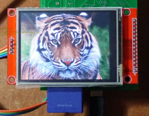

The first demo program contains the code to write an image saved as a binary .PPM file to a ILI9341, ILI9163 or ST7735 display. The tiger image saved as a .PPM is included in the ZIP.

2015-12-03_175102_SDCardV102.zip
This has also required making some changes to the picture drawing routines as they were previously holding TFT-CS low throughout the drawing whereas now this has to be toggled to allow interleaved SD card access to the SPI bus (C code also attached below).
The complete example code for the standard SPI ports to display an image is below.
drkl: Note that this code includes what you asked about in the other thread. i.e. it has a CFunction that can write out a full colour bitmap. The usage should be clear from the example. First define the screen region and then send repeated strings containing the RGB information for each pixel as 3 byte per pixel, top left to bottom right. In the example I repeatedly read 255 bytes from the SDcard (255 / 3 = 85 pixels) and then use the "DisplayBuffer" routine to write these to the display.
All: The SDcard CFunction for SPI2 is unchanged from V1.01 above. However, you should use the new display routines for loading pictures as they are better "behaved". Note that the "CompleteDisplay" routine is no longer needed as TFT-CS is now released at the end of each call to "DisplayBuffer"

print "Picture too big", width%," x",height%
else
Result%= SetRegion(StartX%, StartY%, width%, height%)
Result%=DisplayBuffer(Buffer$)
Buffer$=STRING$(255,chr$(0))
do
Result%=SDcardSPI1(fileheader(),readfile,buffer$,-1,255,NumBytes%)
if numbytes%<>0 then Result%=DisplayBuffer(Buffer$)
loop while NumBytes%<>0
endif
else
Print "Invalid File Format"
endif
END sub

drkl
Joined: 18/10/2015
Location: Hungary
Posts: 102
Posted: 09:49am 04 Dec 2015
Dear Matherp,
Thanks to the modified program, it works perfectly. The tiger is beautiful. My question is to be used for data collection purposes is the same solution. I apply given the SPI2 solution using BASIC program if the replaced part C function? I'm sorry, but I can not in C programming.

I was wondering how much larger the code would be if Chan's FatFs is used so we can get the ability to create files for logging purposes?
Also I had some problems with using the SD functions on the LCD Backpack. When I use OPTION LCDPANEL ILI9341, LANDSCAPE, 2, 23 with the Touch disabled and SD_CS = 6 I get "Unable to mount Disk". How do you set up the LCD Backpack for SD functions?Edited by micronut 2016-04-02
micronut
Joined: 03/09/2014
Posts: 37
Posted: 03:52am 01 Apr 2016
I did a little research and found that the SD Card SPI pins are the 4 hole header on the opposite side of the display.
Geoff had enough fore thought to put the SPI connections on the breadboard compatible header. That makes things much easier. All I have to do is solder a 90 degree male header on the LCD and I'll be good to go.
