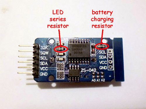

The rtc modules that Geoff pointed to come with a charging circuit for LRI2032 chargeable lithium cells. What effect this circuit would have on a standard cr2032 cell I no not.
If you have used this module with the cr2032 I would like know if there is a problem or not.
Cliff

The battery is an LIR2032. I'm correcting you to make it easier if you search. There is some mods around to remove the charge from the battery. Check out this link and read the first user comment on the second page.

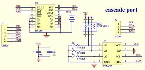

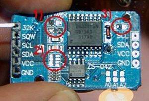

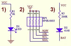

the user manual (an archive containing a collection of documents) does provide a useful schematic which matches the PCB i bought on ebay. direct link here:
http://m5.img.dxcdn.com/CDDriver/CD/sku.222910.rar
it appears that the battery is fed from Vcc via a diode and 200 ohm resistor for charging purposes. it is therefore NOT a good idea to fit a CR2032 cell UNLESS either the diode or 200 ohm resistor is removed. at the same time, removing the LED and/or 1k series resistor may be prudent to save on 2mA of Vcc current.
indeed, there is no real need for a rechargable battery to have been designed for in the first place, as in standby mode (Vcc off, no signals applied to SDA or SCL) the DS3231 draws an average of less than 3uA from the battery.

As noted above there is some info on the web......
https://edwardmallon.wordpress.com/2014/05/21/using-a-cheap-3-ds3231-rtc-at24c32-eeprom-from-ebay/
the above gives a great deal of information including a complete circuit of the device.
Cliff
