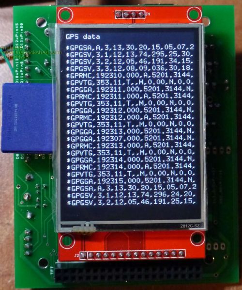

Also:
' Demo of scrolling text in a display - GPS monitor
option explicit
option default none

definescrollregion(fixedspace%,0) 'whole screen except top 21 lines, leaving 23 lines of 13 pixels
s$=chr$(0)+chr$(0)
i=controldisplay(&H37,s$) 'set the scroll area to normal
text 0,0,"GPS data"
nextslot=0
do
s$= GetGPSRecord$(i,arg$())
TEXT 0,nextslot+fixedspace%,s$)
nextslot=nextslot+13 'add in the character height
loop while nextslot<299 'loop until the screen is full (320-fixedspace%)
do
nextslot= (nextslot+13) mod 299
scrollstart=(nextslot+13) mod 299
j1=(scrollstart+fixedspace%) mod 256
j2=(scrollstart+fixedspace%) \ 256
s$=chr$(j2)+chr$(j1)
loop
end

twofingers
Joined: 02/06/2014
Posts: 1783
Posted: 02:59am 26 Nov 2015
Hi Peter,
I can confirm your second code works (P mode, MM2, BP170)!
Thats fantastic! And it offers new opportunities for the mites world!
Michael
